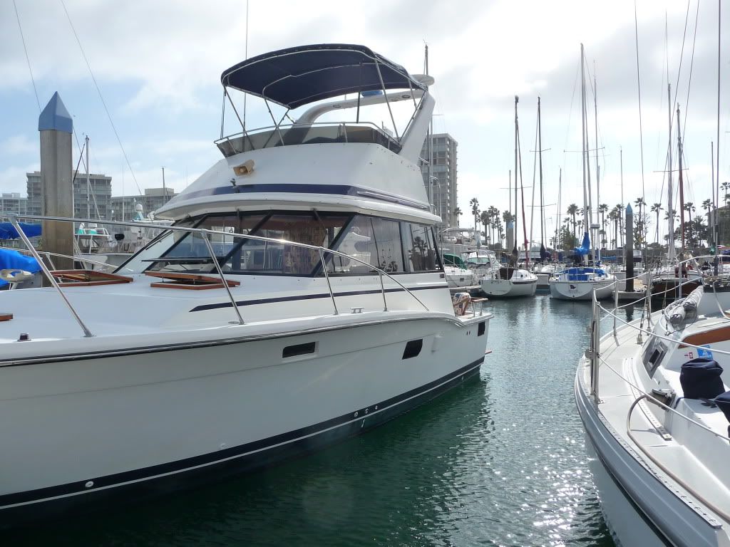

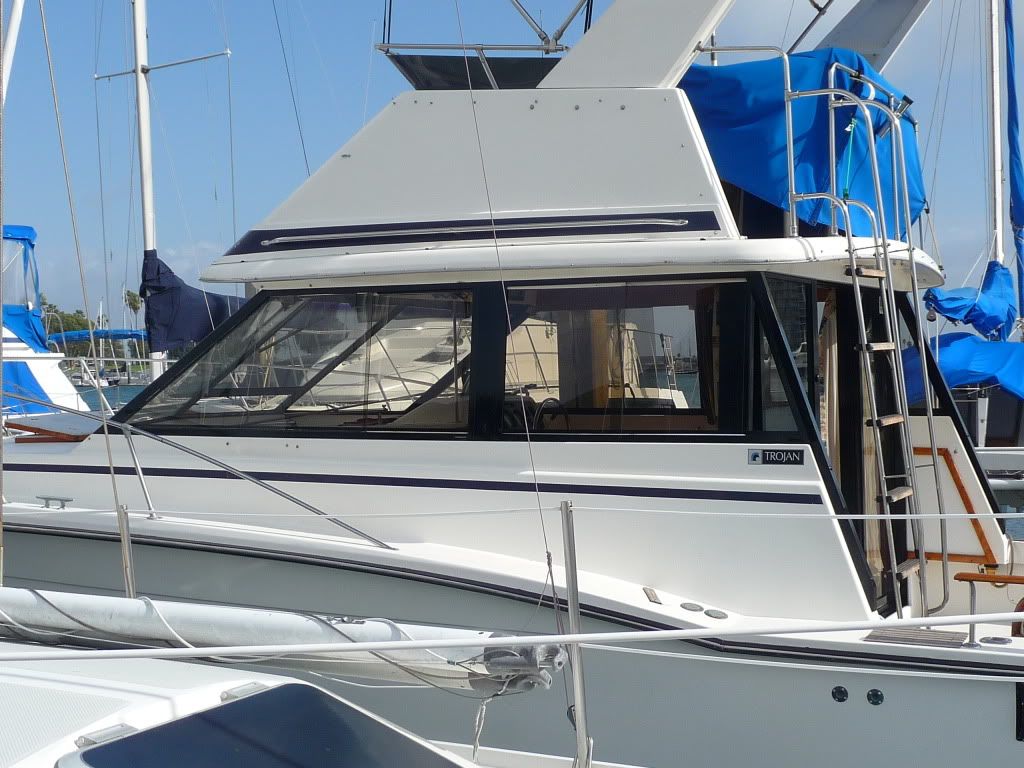

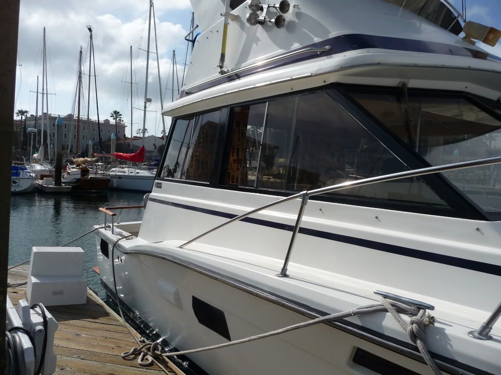

I spent the weekend painting the window frames and I replaced all of the port side glass. For some unknown reason, all four pieces of window glass were cracked on the port side of the boat when we bought it. This project has always been on the list, but has ranked as "cosmetic" on the priority list.

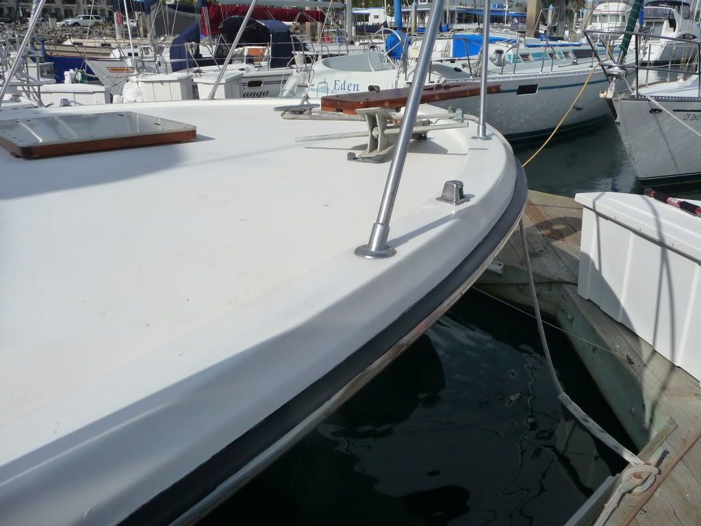

I primed with self etching primer and painted with brightsides gloss black, I also painted the rub rail base in satin black brightsides. What a huge difference in apperance when you walk up to the boat.
I replaced the glass with tempered in lieu of laminated, all 4 pieces, tinted in bronze, polished edges and tempered 258.00.
I must say IMHO that the H frame plasitc thingy sucks, who thought up this half a$$ed way of installing a boat window, its like a shower door!
for those interested, here are some photos

Nice. Very, very nice!
jefflaw35
Post by jefflaw35 »
That looks great!!!

getting to the painting of the rub rail and frame. did you brush this on with out thinning the paint? as you are aware, the aft state room window frame on my boat is looking rather sad and i'd like to spruce that up a bit. i'd also like to do what you did for the rub rail. did you tape all that off so the line is razor sharp? will bullfrog tape work?
