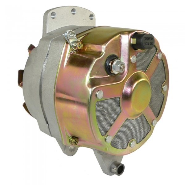

The old alternator is a prestolite ANE 5202YS or Chrysler 3527502 single wire with B+ terminal (Battery+) and B- terminal ( Battery -). The new alternator is a single wire Arco 63 amp
New 63 amp 12 volt marine alternator
Internal regulator with negative ground
Self exciting 1 wire connection
Internally regulated
Saddle mount style mounting foot
Single groove pulley included
Replaces Prestolite ALE5201A, -B, -C, -S; ALE5201S-1, -SS; ALE5203, -A, -S; ALE5209; ALE5220; ALE5220YS; ANE5201, -S; ANE5202, -S, -YS
My main concern is what do I do with the wires on the old external regulator? Do I remove the regulator and leave the wires taped off? Do I join the two wires where the regulator was removed?

You can leave them (Wires) or tape them off . Same with the reg. I won't do anything . My self I would remove as much wiring as I can and tape up the harness remove the regulator just to clean things up .
