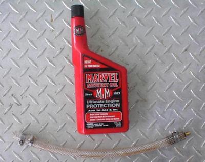

Follow up on this....
I made the oiler gizmo as pictured and used my portable battery pump fill it up to 50 PSI. After 3 hours, it did not seem to move. I ran out of time and left it to deal with later.
I was back today after about a week and all the oil was gone! I checked for leaks and I expected it to be running down the length of the cable... Nope. So I check the tranny side where I left a white paper towel and it was stained with red oil I hooked everything back up and wow! What a difference.
The loosey-goosey side needed a washer on the inside of the cotter pin.
