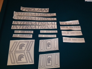

here they all are:
In addition to what everyone was expecting, in BLACK & PEWTER, we will each receive:
additional pair of 10 METER in silver
additional pair of INTERNATIONAL in silver
additional pair of incorrect SIDE LOGOS
Brinkerhoff will receive same as above, but his are 10.8
all will ship tomorrow.

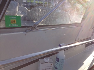

I used a heat gun a soft putty knife to remove what could be removed that way.
I used a 3-M Eraser wheel in an electric drill to get the parts that were basically melted/faded/fused into the gelcoat.
after a compound session, I wiped everything down with M E K (methyl ethyl keytone) its less harsh than lacquer thinner.

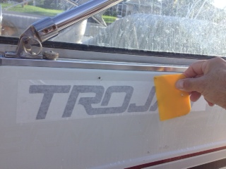

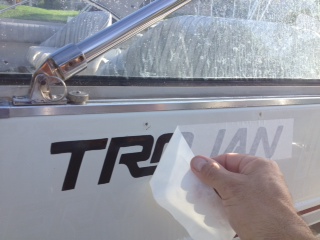

Peel the backing off. Then A few drops of DAWN in a spray bottle sprayed on the boat and on the back side of the vinyl will allow you to slide the sticker around for the best "fit".
squeegee it down, then gently peel the top paper off ON AN ANGLE!
Here's some pix.

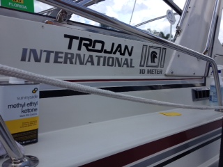

Re: Trojan International Logos NOW WITH PIX
finished job !
