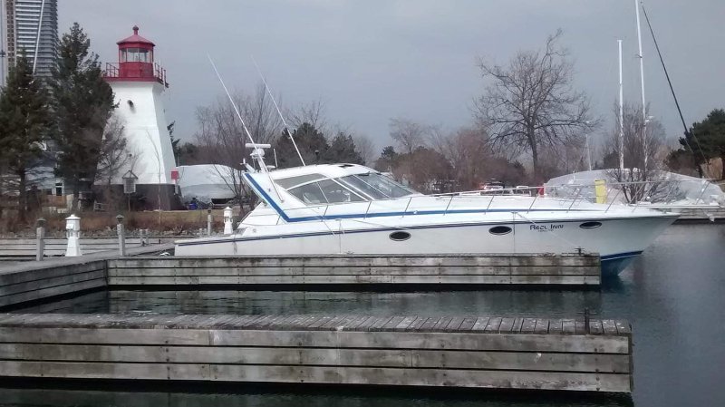

@Rick - boat should be going in tomorrow! Driving her in the lake from the marina to the west end of Toronto on the weekend if all goes well. Decided to go with a yatch club instead. Having reciprocated access to all other clubs on the lake is a huge bonus. Plus cheaper in the long run. May consider doing the liveaboard in the future, even in winter.. but we'll wait and see.
Thanks for the comments guys!

Welcome to your new home! So looking forward to the 2019 season!

You can see how big a 13 meter is in that photo . Nice
