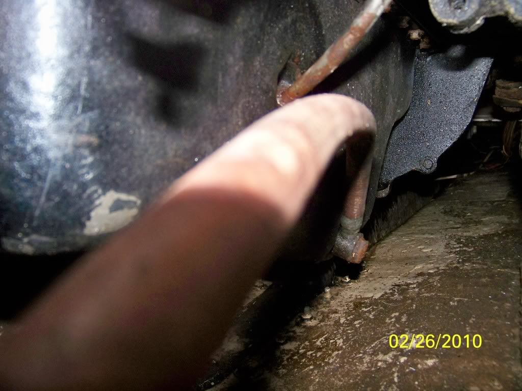

My engine has a rubber hose connected under the oil pan where the drain plug used to be my oil drains that way.

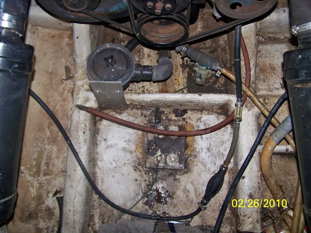

Rodman
Posts: 468
Post by Rodman »
LandVF36 wrote:After trying and being dissapointed by the commercial pumps for this purpose, I bought a small 12 V "flojet" ag pump at the local tractor supply for $32. (yes, its explosion proof, sealed switch and all). I stepped over an isle and go some 3/16 poly line and some theaded npt fittings with hose barbs. This and couple of empty milk jugs and you have a portable changing system.
This is the hose i was referring to early in my post.
Image[/img]
Trojan
Posts: 12732
Rodman you need to rid of the automotove fuel lines and the b-2 fuel line and replace them with A-1 marine rated hose ASAP
Rodman
Posts: 468
Post by Rodman »
prowlersfish wrote:Rodman you need to rid of the automotove fuel lines and the b-2 fuel line and replace them with A-1 marine rated hose ASAP
I plan to do that over the weekend, Thanks
Trojan
Posts: 12732
Always something more to do
Rodman
Posts: 468
Post by Rodman »
prowlersfish wrote:Always something more to do
U got that right. I hope to get it right by the spring, I take it last owner really neglected the boat.
