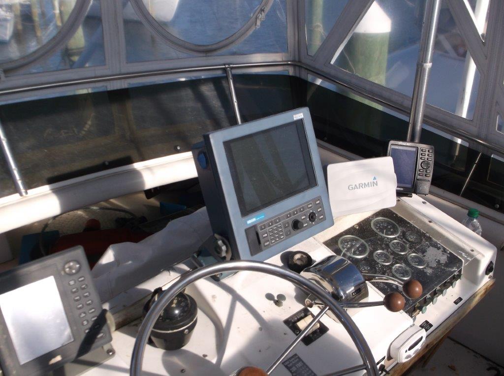

Finally able to post a photo..
Here is Dan Faith's F32 upper helm:
Posts: 12730
Re: F32/F36 Upper Station Console
That's like the newer F36 ones
