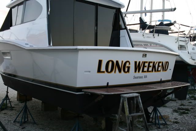

I did my F-32 with interlux Brightsides and I was pleased with the results. It's only been 2 years but seems to be holding up well. Tough to see in pics.

here's some better shots of the sheen of brightsides.
Posts: 12724
Jav that has got to be the niceist look F32 around . Are you ready to make my new vents yet ??
