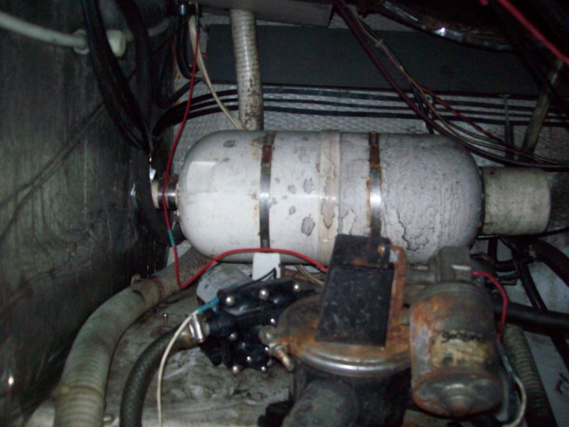

RWS, well poop, oh I mean well put. You are making a convincing case for trying to get it fixed. I have asked about getting it check with a local expert here using the local fishing forum. No response. I guess the approach would be to check out the vac motor since I don't get any response from it. Don't know if there is a cut out switch involved that functions for other issues like lack of water or a full holding tank. The boat manual I have indicates I should refer to the mfg manual which I don't have.
Anyway, will see if I can sort it out before I start cutting. Don't need it until fishing seasons starts so have some time.
Also have to figure out that black fixture which I believe is a y valve of sorts. Since the macerator motor runs and if I can get the valve set could find out if tank full or not. But hate to force that as a valve, since if something breaks understand the outlet for the macerator discharge is right at the water line and don't want to contend with a flooded boat. So everything may have to wait until haul out after Christmas.

So Fighter, What Vacuflush model is that in the photo anyway??? I don't recognize it. It does indeed remind me of what we always called the "Air Canada Heads" that I had when I first bought my former 36 foot TriCabin. Maybe P Dogg had one as well.
Rick
Re: Vacu-flush system replacement??
The cylindrical one is the old style. My new heads are served by rectangular tanks maybe 8x8x18, with the pump integrated into the top. Tank is under vacuum (i added vacuum gauges because none were provided by the factory, and thats what engineers do). When head is flushed, the goods get pushed into the tank by the column of air between toilet seal and outer space. Vacuum switch senses change in pressure in the tank, and the pump pumps the goods from the vacuum tank to the holding tank, which i placed immediately below vacuum tank. It is not much of a vacuum, only 10" of Hg, so the "vacuum" tank is 2/3rds full of air when ready for action.

AFter reading RWS posts I did a little more checking this morning. Toilet lever up puts water into bowl, but toilet lever down, nothing happens. If the water leaks down that would be an indication of a seal issue.??? Would that also indicate the line isn't already full?? As well as the holding tank. Can the water gravity feed thru the system if the seals aren't good? Will have to trouble shoot starting with is the pump getting power and go from there. That is another day, next week. Not really looking forward to taking it apart. LOL.
One more item--don't know if I posted this or not--When I flip th head switch up it pops right back down in about a second. To me this indicates a short somewhere--probably a seized motor in the vacu pump.???

One more opinion needed. Looking at the pictures of the toilet installation. I am guessing the pipe leading into the end of the Vacu Tank from the forward bulkhead is the flush pipe from the toilet. It appears to be an 1 and 1/2 inch pipe. Is it fair to assume it is 1 and 1/2 diameter up into the bowl of the toilet? If I can get the water out might be able to check it, but ??????
If it is 1 and 1/2 inch than could it be diverted and drain directly into the holding tank which is lower. Since lifting the lever up on the toilet brings in water and the slide valve for dumping is about 3 inches, why couldn't the existing toilet work like the Jabsco Twist and lock manual 29090 toilet?? Of course this is dependent upon the outlet being 1 and 1/2 inch diameter vice the 1 inch mentioned earlier in this post.
