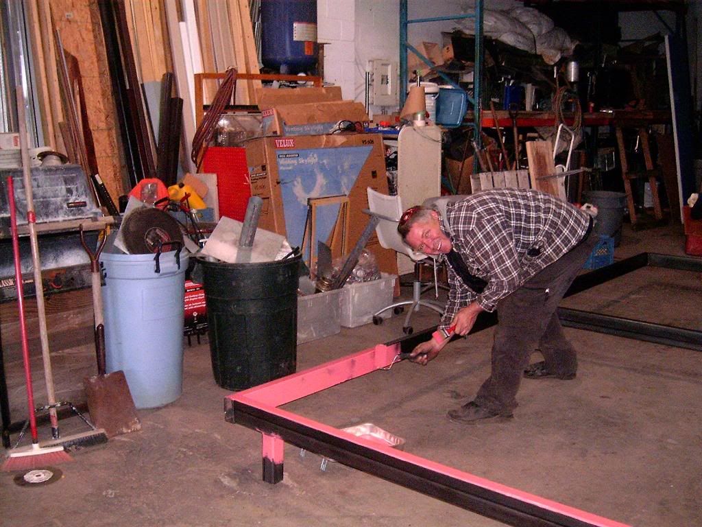

Post by rooferdave »
here is an update on my cradle, made it out of 1/8 wall and 3/16 wall tube
going down to the club today to see how high my keel supports should be. The side supports (the cradle is currently upside down for paint) are 34" high and will have adjustable scew jacks fitted to the top of with wood and carpet.
http://i948.photobucket.com/albums/ad32 ... IM3680.jpg
http://i948.photobucket.com/albums/ad32 ... IM3682.jpg
http://i948.photobucket.com/albums/ad32 ... IM3683.jpg
http://i948.photobucket.com/albums/ad32 ... IM3684.jpg

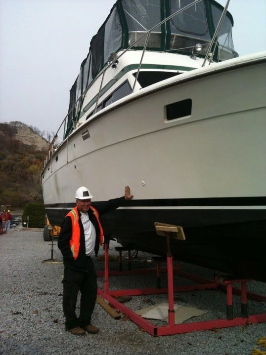

update
got the cradle built and just need a few minor adjustments and a bit more paint.
got more than a few comments on the paint job!

Post by 13footbeam »
rooferdave, The cradle looks great if you are on ground that does not shift with the seasons, but it looks like it is a bit short and the main frame a bit too flexible, are you having to support the stern with seperate jacks? If so not good, this will be a problem because as you stated earlier, the ground shifts and if it does in your case it will put things out of wack which could affect the hull. Making one complete unit would eliminate the problem, but it would also need to be structurally more solid as well so no matter the points touching the ground surface it will stay true to the boats hull shape and not flex. Kind of like a fork lift, if one point comes off the ground, it does not flex. I think you could improve your design by adding some more beef but if I am seeing things corectly, you still have the issue of being too short, there is a lot of weight in the stern if your boat has the V-drive set up with engines and transmissions in the rear of the boat. Sorry to be a downer
thanks for the input Pat, greatly appreciated, size of cradle is dictated by the club storage. I modeld my cradle after another trifly in my club and was limited to keel length for position of cradle, for next year we will raise the back keel support to allow the boat to sit further back. The frame is 2x4 1/8 steel and the uprights are 2x2x3/16 steel and braces are going on next week, also new rear supports as it was a bit of a shock that I needed them but with a 600 tonne crane and 16 man crew I did not have a lot of time
