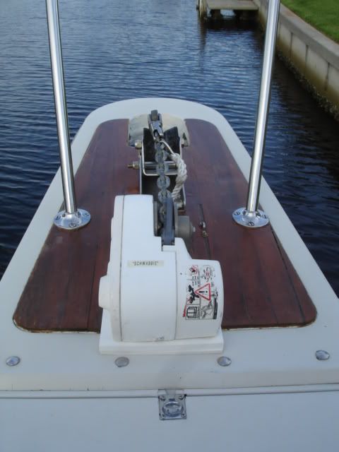

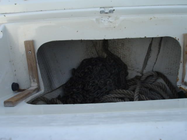

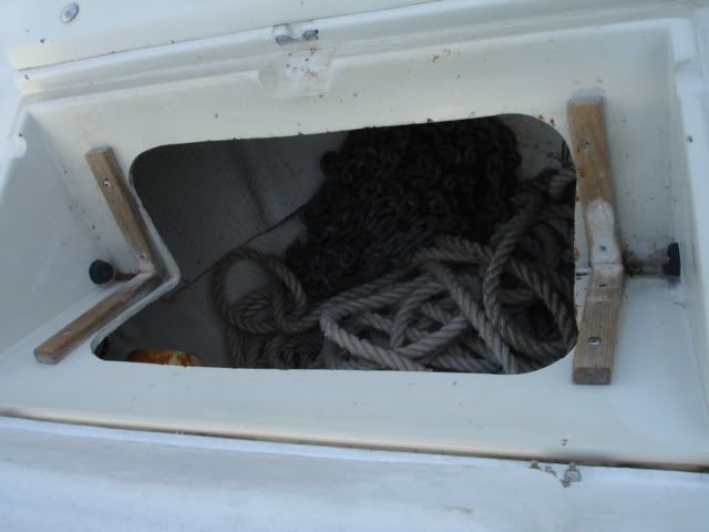

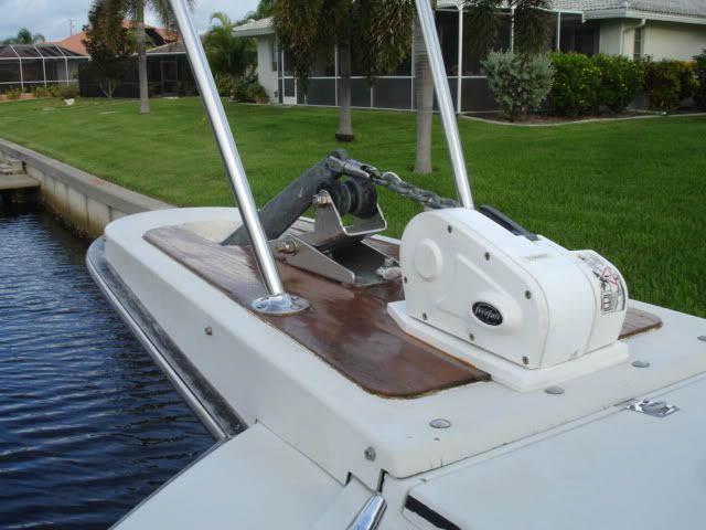

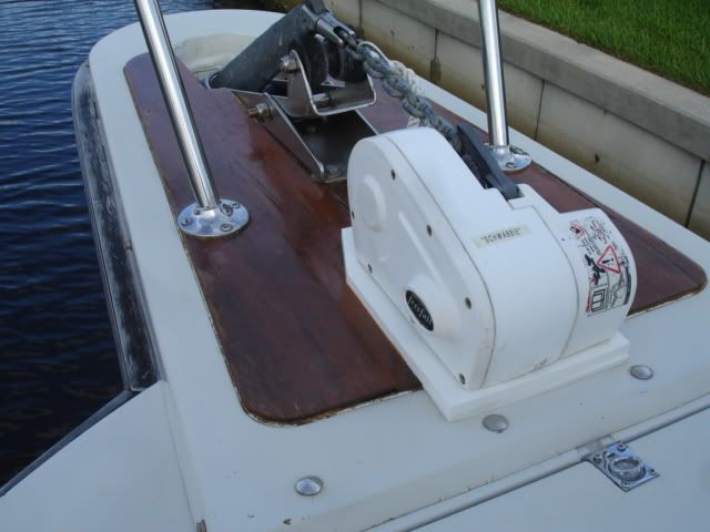

I chose to mount mine just forward of the anchor locker.
This gives me access topside to the locker.
In retrospect, it should have been about 3" farther aft to avoid occasional issues with "piling" up the 30' of chain on my rode.
