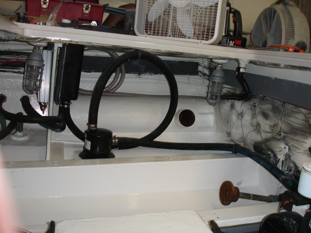

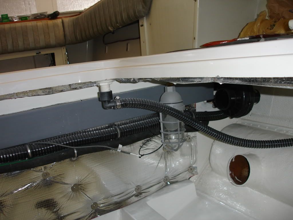

Here are three shots of my engine room with the 454's removed, just prior to installation of the new engines.
You can see the exhaust opening into the Shoell side exhaust mufflers. These are basically large chambers built into the hull liner.
Perhaps there was a seawater intrusion issue that could not be found and the owner or ignorant yard guy plugged all of the openings.
I found a large sampling of rust flakes to vacuum out in the bottom of mine from 20 years of risers and elbows being in salt water.
I believe you will find that the openings in the engine room are above the water line (you better confirm this)
Hope these photos help.

Holy shnikes! Thats freakin clean. Makes me feel ashamed.....and i will be headed down to scrub mine this week.

RWS: What kind of paint do you use down there? 2-component epoxy or...?
I used BILGEKOTE made by Interlux
Bilgekote is a fast drying, durable coating formulated for application to bilge areas. Helps prevent absorption of oil, gasoline or sludge into wood and fiberglass.
Bilgekote protects bilges, lockers and bulkheads against moisture penetration and wear and tear. Bilgekote will resist oil and fuel spillage and cleans easily.

While it looks nice here, you should have seen it when we started.
By the way, looking at these pictures now makes me realize just how valuable the relocating of the AC compressor & heat exchanger , fresh water pump and plumbing and the sanitation system pumps and plumbing was.
I now have so much more room to get around the engines, I mean all the way around. Of course the Yanmars are longer & taller but not as wide as the 454's.
