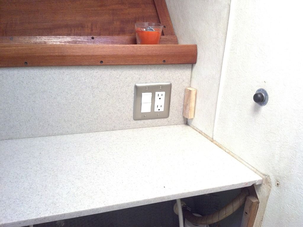

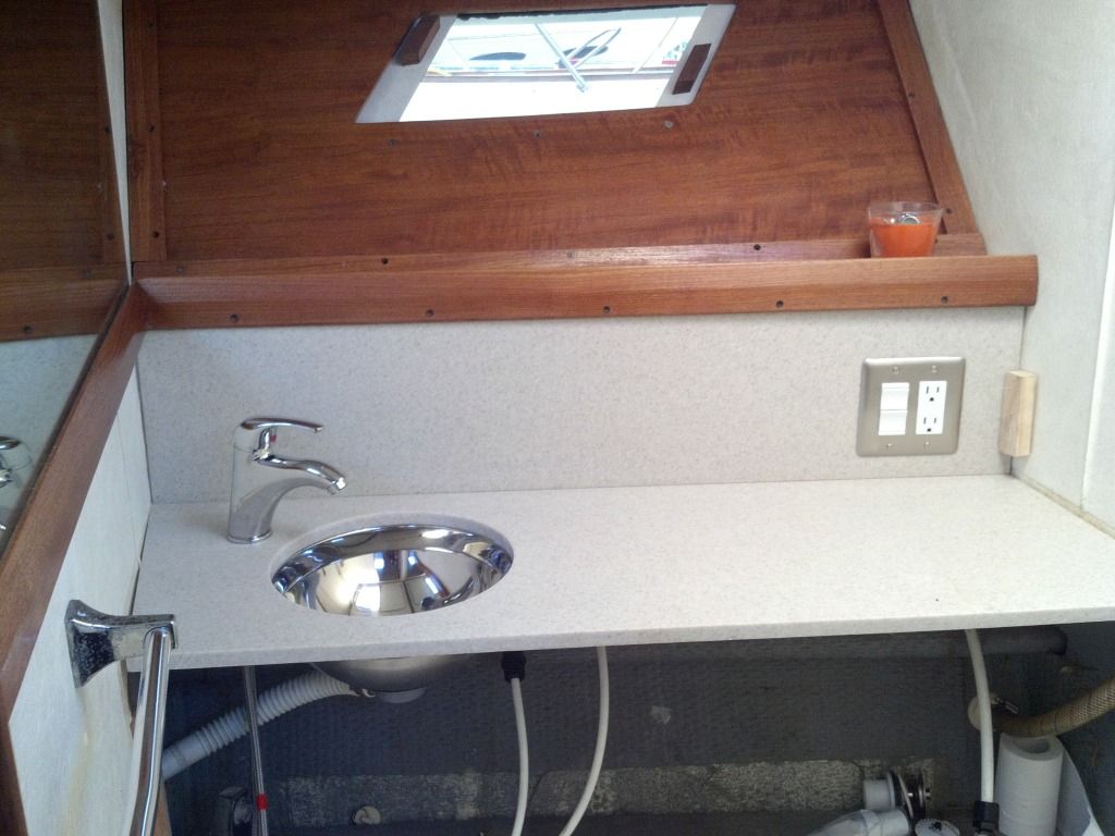

here are some photos of the galley and head redo..
the little block of wood on the right side is a temporary block to hold the corian back splash until the adhesive sets.
notice the new dual switch and outlet, if you remember, the original blower and shower pump swithces were automotive style push pull switches . I changed them to a dual outlet box with a two swich -switch for the shower sump and for the indirect lighting I installed, I removed the blower vent

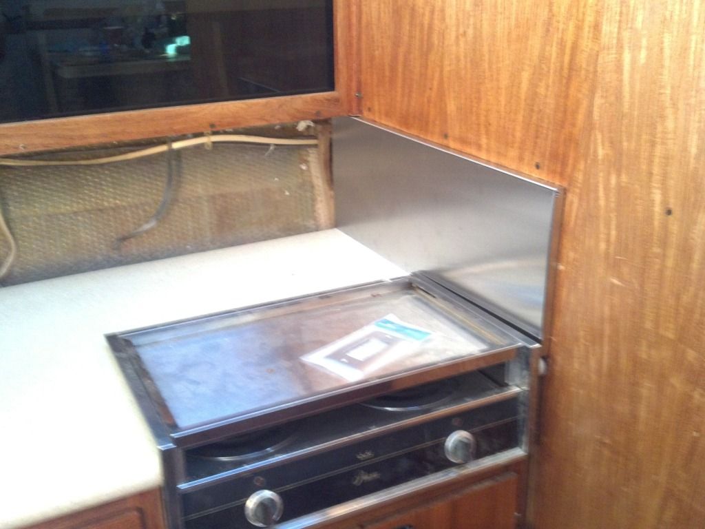

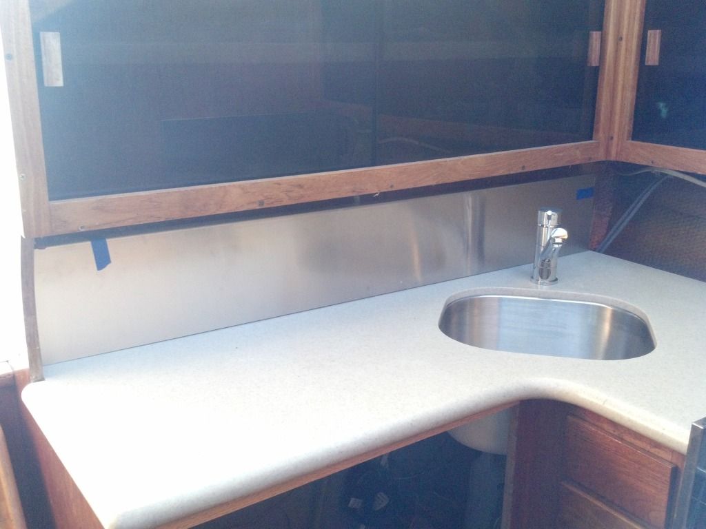

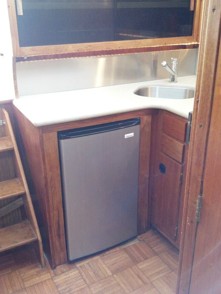

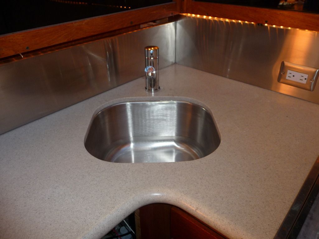

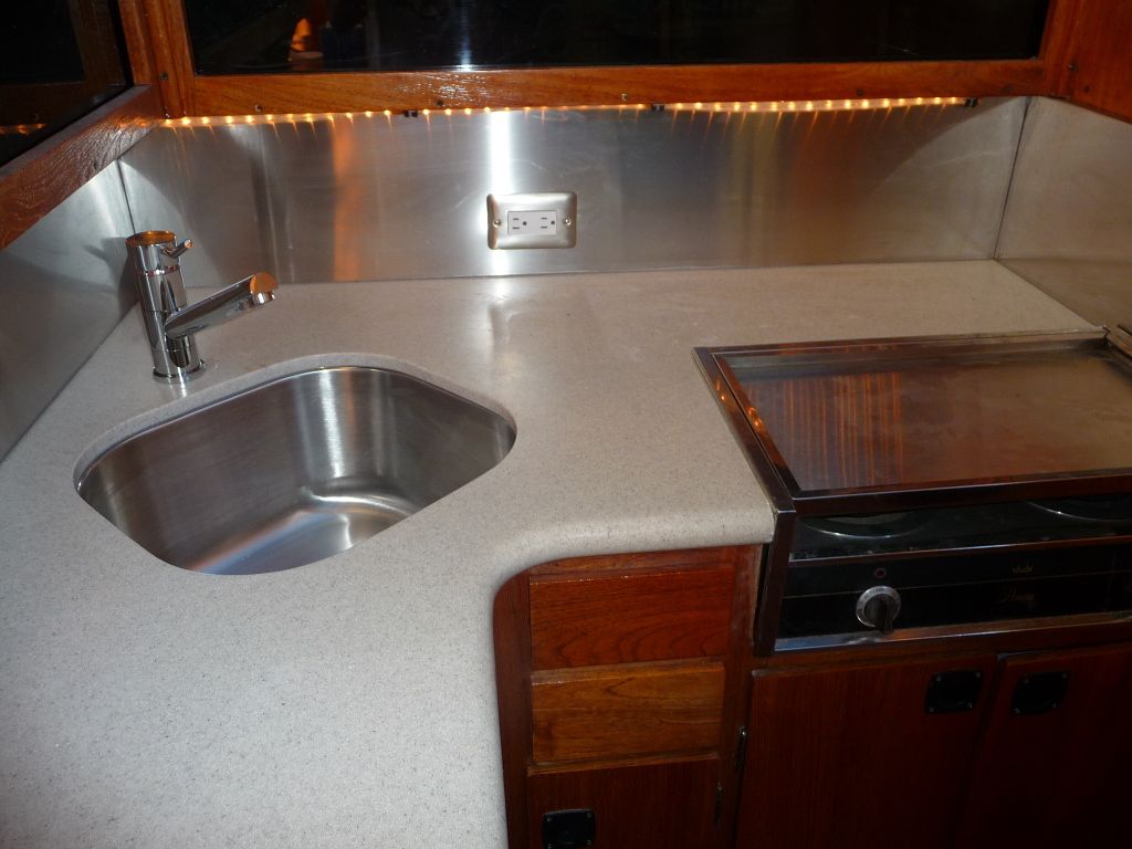

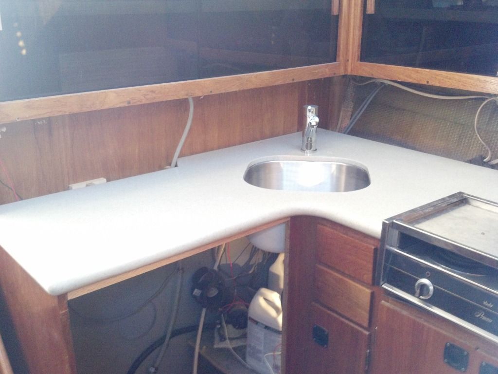

I have just about completed the galley and head counters, I still have a few little details, the new fridge needs to be closed in, backsplash strips in the head, I am going to put some sort of valance or strip in front of the rope lights to hide them and some trim work, but all in all I am happy with the end result.
BERFORE
AFTER
BEFORE
AFTER
BERFORE
AFTER
BEFORE
AFTER

Looks Great! Impressive update. Where did you find the new sinks? I love the deep galley sink. Never worked with corian but there is a discount place near me that sells left over corian pieces and overstock. did you just glue an extra piece to the underside of the front lip and round it with a router?
Good choice on the color, they really look good.

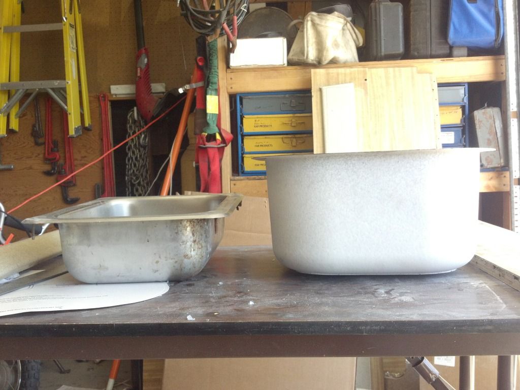

thanks for the note, I ordered the galley sink from "mr direct"
http://www.mrdirectint.com/kitchen-sink ... mount.html
I got the head sink from Westmarine, they had it in stock and in the small diameter required for the small vanity top in the Trojan. It cost more than the galley sink but still 40.00 off with port supply
I got the sink quickly, and it looks great, completely soundproofed and of a heavier gauge than the cheap home depot or Ikea versions.
As far as the rounded edge, they were already on the corian peice and this added to the complexity of the project as I has to match and fit the edges, inside and outside courners, rememeber, I got the corian from a home kitchen wreck out.
I ordered the Corian adhesive and the "cheap" glue gun from Glue Warehouse,
http://gluewarehouse.com/
I matched the corian color and pattern from the corian website color chart and then ordered the appropriate adhesive.
I found the Corian fabricators guide online:
http://www2.dupont.com/Surfaces/en_US/a ... inting.pdf
and I followed the instructions that applied to my project exactly
including the sink cutouts, the part of the corian project I was most concerned with hopeing to not screw it up, as I didnt have enough matgerial to correct the corner if I screwed up the cut.
I took my time and planned every cut and every piece very carefully and would hold my templates over my corian pieces before cuts and glueing to make sure I had the cuts, and orientation correct.
in the end, I had to buy a glue applicator, mixing tips and a 2HP router with a 1/2" collet, my 1-1/2 HP router has a 1/4 collet and I couldnt readily get the carbide router bits of the correct length to cut through the edge not to mention that 2 HP is on the small side according to dupont.
The corian cuts easily with a good bit, but it makes a lot of duct and router chips, so it is very messy , do the work at home and only trim at the boat, (Dupont tells you this on the manual)

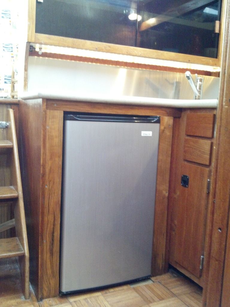

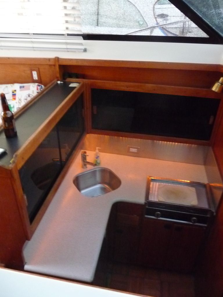

here are a couple of up date photos of the project
I spent a little of my "recovery time" finishing the details, I kept tring to figure a way to finish off the refridgerator opening around the sides and top of the fridge in an economical way, I finally broke down and just bought teak, $ 50.00 for two boards, Frost Hardwood supposedly gave me the cabinet shop discount...hmmm
My wife said I have spent enough time in recovery and to now get busy on the built in sofa and new floors....
sorry for the glare and i used my Droid camera

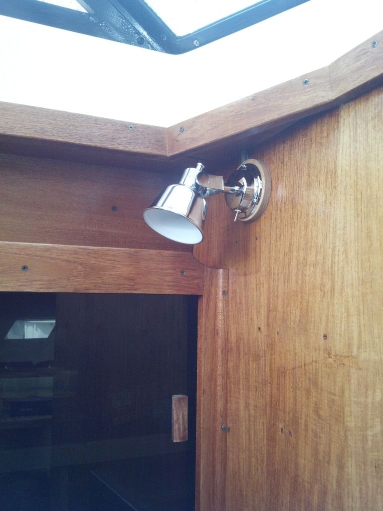

New Light for the galley
Added the backsplash end pieces and a new towell rack
