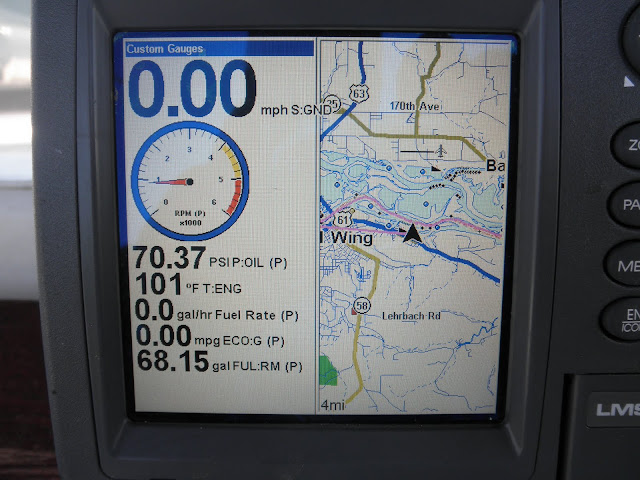

Rossjo, just for you... And for you Paul, its closer, not bigger :lol:
So, here is a better picture of what I'm currently monitoring.
There is an option to monitor N2K messages and do alarms, but I have not yet configured this option yet. I'll keep you posted when I have time to get that going.

Love it. You're a politician (hope that wasn't an insult) - I suppose you do you need to run to be King.
That setup is awesome - does it record His and Lows as well?
Connected to your Flo-Scans as well? Nice!
Last comment (let me be 1st) - 70PSI Oil Pressure @ 900RPM?
LandVF36
Posts: 436
Location: Minnesota
Post by LandVF36 »
The PSI is pretty close. I run 40W oil and took this picture about 10 seconds after start-up. After about 5 min, she settles down around 40. I do need to do a little bit more calibrating though.
Software in the Lowrance display does not record highs and lows. I also need to do a software upgrade on the displays apparently to allow more "alarms" Hopefully, I'll get some more time this weekend or next.

I like it.
Did you varify pressure with a mechanical gause at engine?

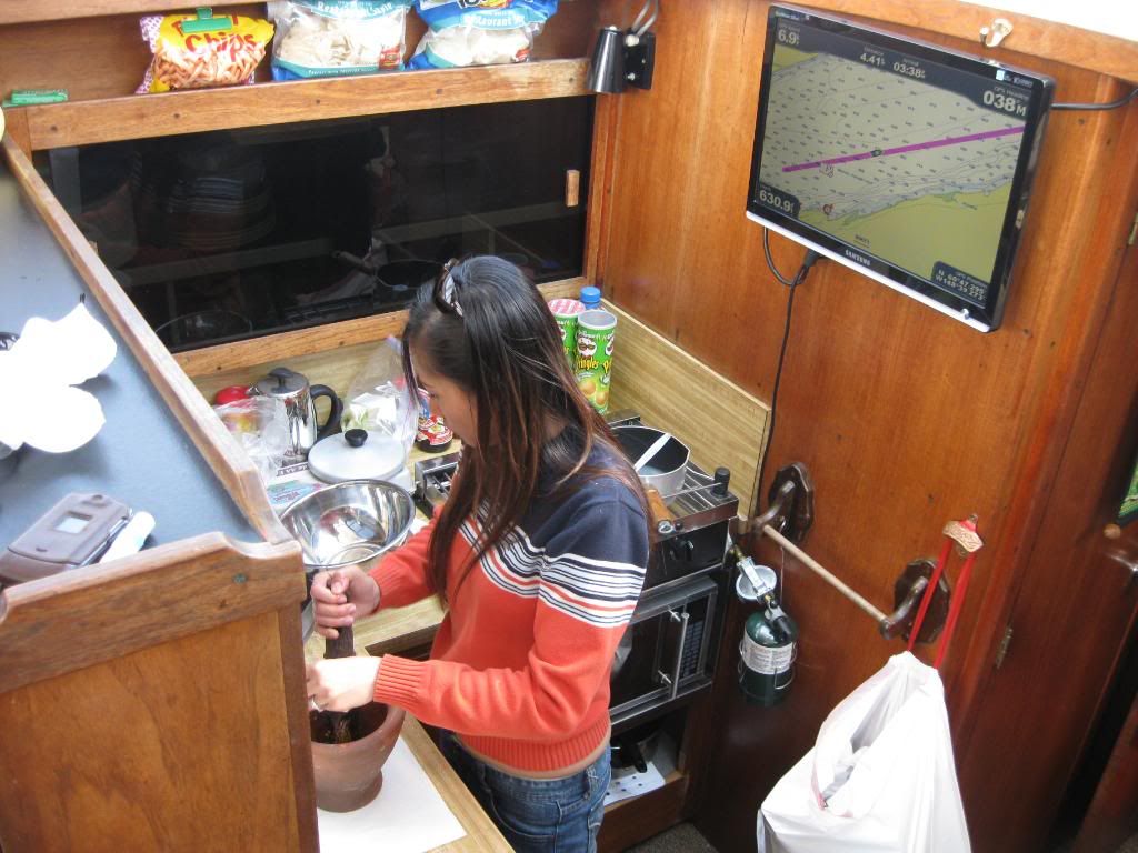

Not really spot on topic, but a cool thing about some of the new electronics... The Garmin 4200/5200 series has a 15 pin monitor plug on the back of the MFD. Buy a $150 monitor, and an 8' cable, and you can have a large repeater screen that can easily be seen all the way from the back of the cockpit.
Nice when your fishing or whatever, and someone else is piloting.
