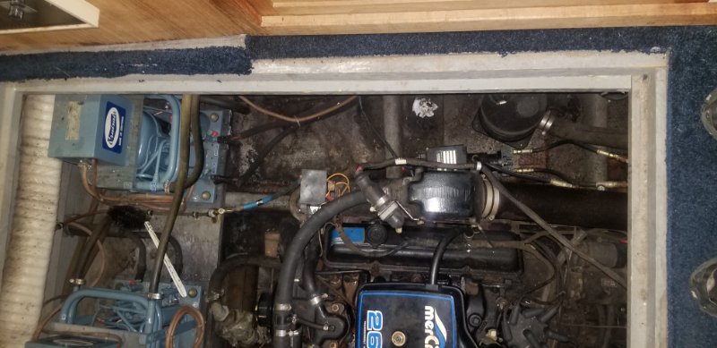

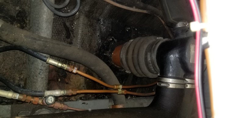

Here are some Pics.
This is the Transom looking down.
Transom Looking Down.jpg (48.73 KiB) Viewed 14684 times

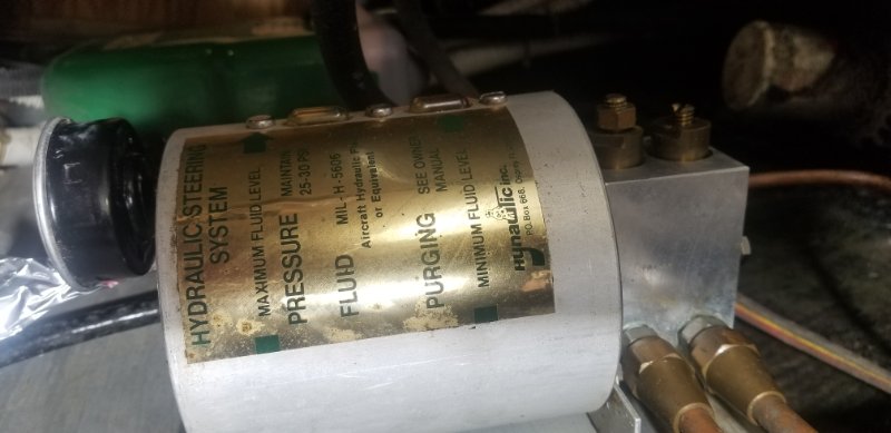

This is the Reservoir for Hydraulic fluid & air Pressure
Steering Resivoir.jpg (46.32 KiB) Viewed 14684 times

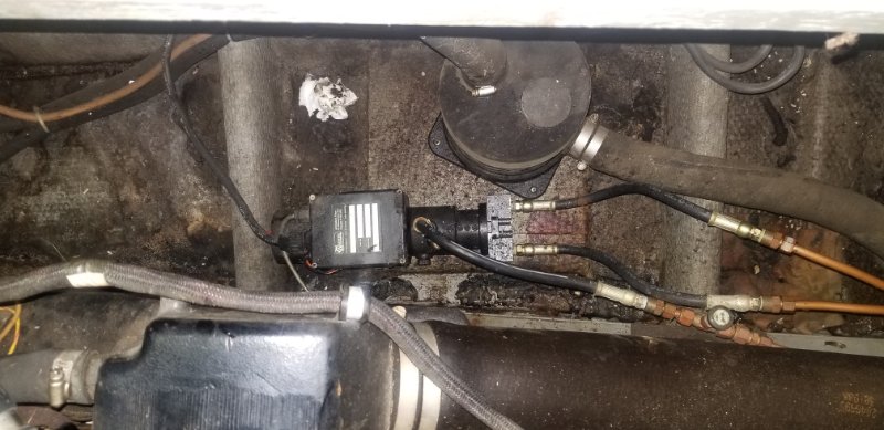

Location of Auto Pilot Pump & Motor
Auto Pilot Pump.jpg (70.94 KiB) Viewed 14684 times
Auto Pilot from Above
Auto Pilot Locale From Above.jpg (68.64 KiB) Viewed 14684 times
Auto Pilot Lines Looking Aft
Auto Pilot Lines heading Aft.jpg (49.04 KiB) Viewed 14684 times

Pretty normal set up . While I would not mount my auto pilot pump there it will be fine . While the ATF won't cause any damage , it can make steering stiff especially in cooler temps . You will notice they list the fluid on the reservoir . You see the green pump/tank next to the tank ? That is for your trim tabs . and that takes ATF . Made by Boatleveler /instatrim FWIW .
Has the steering gotten any better ?

The system is Hynautic After filling the tank/reservoir you put air pressure in the tank . The air pressure forces the fluid to the helm pump as the tank is mounted down by the rudders .
