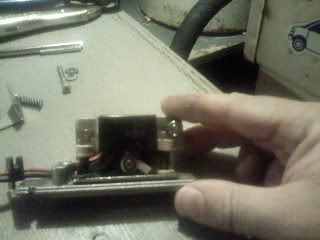

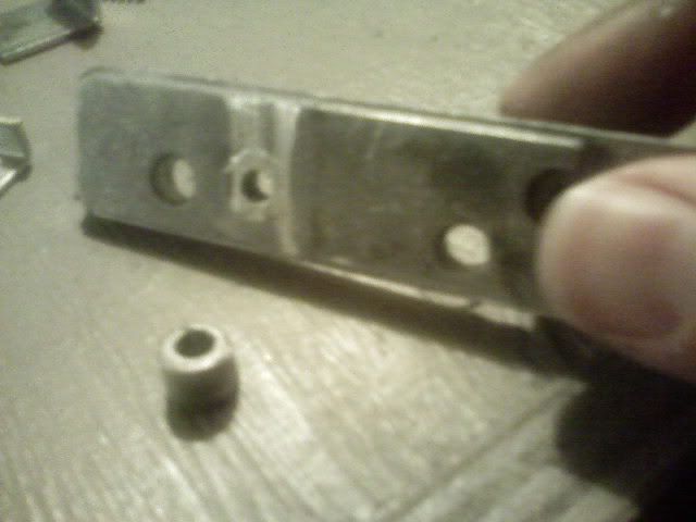

When I got to install the Ignition I found that my new base has a round piece protruding that made it NOT fit up on my Onan where my Points/breaker box tower used to be. So I cut the piece off to make it fit properly.
After that this is what the whole ignition looks like ready to go on.

Yes, it is part of the hole that the plunger fits into. The plunger still works properly and has plenty of space. That little tube i cut off was for the GMC motohome version.davidsmith wrote:Is the part you cut off is where the plunger fits?

The black wire is grounded to chassis ground. The red wire, I have tried on the positive lead off the thermo switch which feeds the coil that has 10.89V on it and I have also tried it on the positive lead that used to attach to the points that also has 10.89V on it. Neither connection gave me a spark from the coil. I am wondering if the low voiltage output to the electronic igntion module is affecting it. I mean does it require 12v+ to orperate correctly or is is made to operate off the 10.89V+ off the coil itself. An why is the coil, that worked before with points, have only 10.89v coming from it instead of 12V?davidsmith wrote:How do you have the ignition wired?
