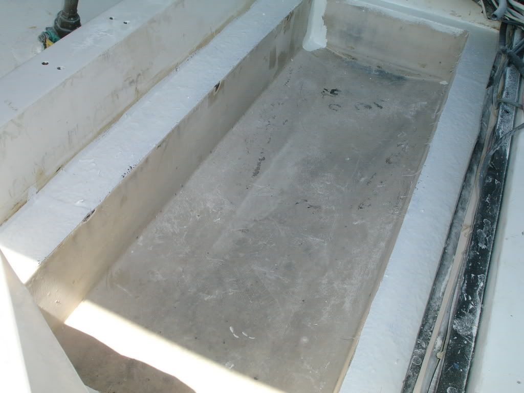

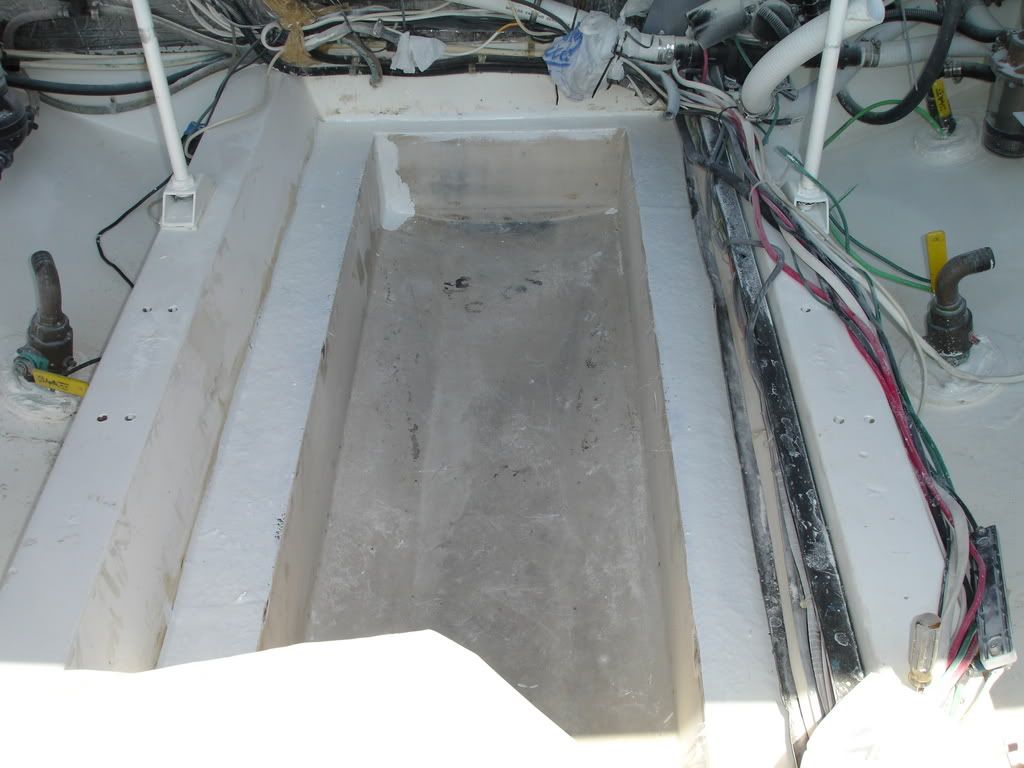

The mid cabin based models had the waste tank as a stand alone unit.
The vacuum liner models had the tank moulded into the hull between the stringers in the engine room.
The tank lid is the engine room floor.
Here's some pix of the latter with the lid removed for resealing.
Here we are with the lid back on:
and another

My pump ended up right where RWS has his mounted on the starboard stringer. Very nice pics that he posted.
I would not worry at all about having the tank in the bilge with the engines.
Are you sure that you don't have a tank built in as RWS pics show?
