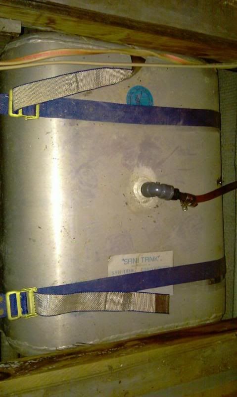

After some trial and effort with the valves i did manage to crawl around and see the tank, there doesnt seem to be any leaks into the bildge and after a few tests i did find that the waste was going into the tanks instead of overboard however there is an overfill discharge there that i can manualy open.... im going to try to duct tape some of the fittings to get a better seal and try again today, i would have tried earlier but my marina doesnt do pumpouts on weekends
ok so im having issues trying to figure out, if any one knows of a good mechanic that can possibly take a look at this for me that would be great...
i found one but he charges 120 per hour and in my opinion that's a bit to much so if anyone is in the Norfolk area with decent prices i would highly appreciate to know of a number or if anyone would want to contact me my number is 718-710-0963
got a pic of the tank... finally got a hole open to get to it...

I would expect to see 3 hose connections to the holding tank....
Inlet, breather and outlet which is usually off the bottom.
The size of the visible one looks to me like the breather... my outlet is at least 1 3/4" bore!
I think you need to do some more looking before spending money.....
can you trace the pumpout hose back from your deck fitting?

I just saw that too. Seems too small for the vent line!ready123 wrote:I would expect to see 3 hose connections to the holding tank....
yes that is the vent line and yes i can see the hose connection to the pump out port... the problem is that i cant get to it... that's what the issue is... there are two fuel tanks that are right next to the waste tank and i cant get under there, also there isnt a single other access point to get behind there..... i just dont know what else to do, my knowledge of this isnt the best...
