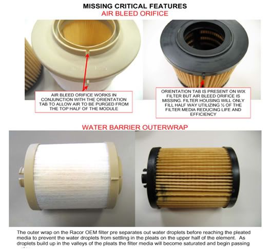

we recieved this bulletin from Ford Motorcraft regarding our Super Duty Fords, while this is ford specific and of course promotes the use of Motorcraft components, it looks as of Racor is manufacturing the fuel filters for the Powerstroke, notice the Wix filter element, Wix is making NAPA?
I use napa as well, but this make you think a bit

On Dodge trucks with the Cummins diesels there was a Issue some years back with the oil filters coming a part and damaging the engines
the mopar bulletin sad only 3 filter where OK to use after testing the Mopar filter ( OEM of course ) Fleet guard ( cummins OEM) and AC all others the check failed the tests . That fact they listed AC shows it was not about using their filters .
