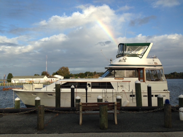

Re: Question on Prop Size For 1979 F44 and Cruise Speed
Attached is a picture of the boat.
Drew

- aaronbocknek
- Posts: 2080
so all exhaust gas/water exits at the hull side port and starboard or transom? are the mufflers inline or lift? as for risers, osco is usually a good source.Lean Wolf wrote:Aaron,

drew, thanks for the portside pic. she is beautiful. so she was the family boat and passed onto you? where do you keep her?
