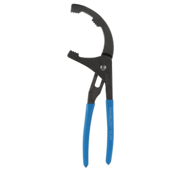

Mine was on real tight. I used PVC Slip-Joint Pliers from Home Depot.

It definitely unscrews. No doubt it's on tight. Large slip pliers will do the job. If you break it this might be your replacement.
