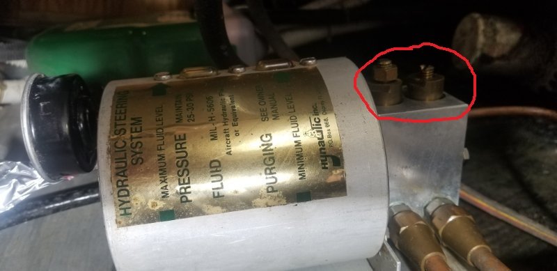

I have an 88 F-36. I have a purge valve in the system near the reservoir. Just like a bleeder valve for breaks on a car. For me I loosen the locking nut, turn the screw on top then turn the wheel lock to lock about 10 times to purge.

I looked for a bleeder port of any sort, and do not see any. I tried spinning th e wheel to starboard several hundred times, then back a few dozen times, nothing. I'll wait until I have a second person on board & try breaking an inlet to the hydraulic ram loose.

The bleeders don't look like a brake bleeder you maybe use to and they bleed internally . Not called bleeders but called purge screws part od the relief valve block .
Yours is mounted below you reservoir , AND I may see a issue it looks like the lock nut is missing on one the lose on the other . One screw looks backed out , so that could be the issue .
Look at your second photo !!!!!

look at the r upper corner of your photoprowlersfish wrote: ↑Sat Jun 15, 2019 10:05 am The bleeders don't look like a brake bleeder you maybe use to and they bleed internally . Not called bleeders but called purge screws part od the relief valve block .
- Steering%20Resivoir loose screws.jpg (46.77 KiB) Viewed 10259 times

Since the photo is sideways, here is what prowlersfish is talking about:prowlersfish wrote: ↑Sat Jun 15, 2019 10:05 amYours is mounted below you reservoir , AND I may see a issue it looks like the lock nut is missing on one the lose on the other . One screw looks backed out , so that could be the issue .

Thanks WayWeGo That is exactly what I was talking about .
And sure would cause the issue

Thanks guys. I'm staying aboard tonight, and will take a look before I make the bed. I will look for the purge valve lock nut in the bilge or replace it if needed, and advise. Thanks again.

Make sure the screws are turned in .

Sorry, been out of the country for a bit. Came back, closed the two bleeder screws, added some pressure back, spun the wheel both directions hundreds of revolutions each direction. No change. At this point, I have so many other things to do, I am going to take care of it, and several other significant issues this winter. Although very frustrating, I have gotten pretty good at good at maneuvering the boat by gear position, and throttle position. I still want rudder control, but next year, after I can see what is going on, inside, and outside the boat with the rudders...
