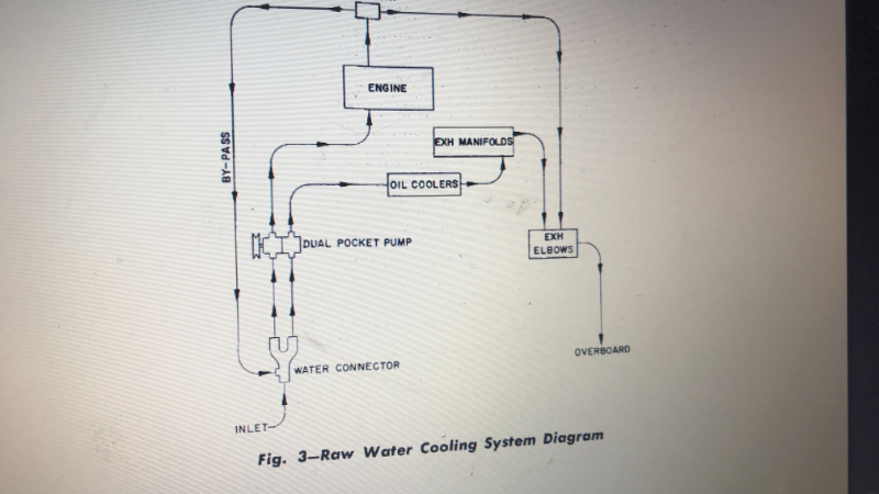

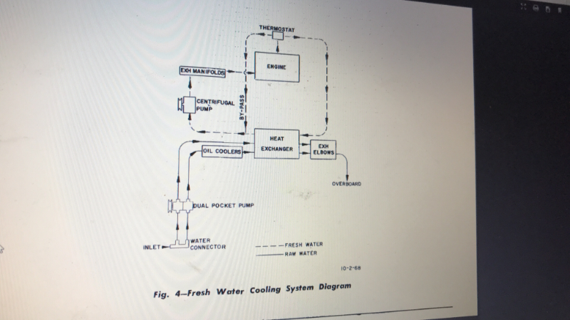

Re: water flow
This should help with the hoses . I posted both types of systems
- Raw water cooling
- m440 raw water.png (801.61 KiB) Viewed 14568 times
- Close/fresh water
- m440 fresh.png (783.8 KiB) Viewed 14568 times

Thanks Prowlerfish & Capt. Maniac, thanks so much for the pump diagrams, I didnt see your message soon enough to tell you I do have the original manuals, so thanks for taking the time & interest for that. To answer the other suggestion, I have checked the oil coolers, which are clear, I can blow through them. Today I hooked up a manual temp. gauge, & the temp ran right uo to about boiling, fast idle at the dock! I am starting to think I may have clogs in the exhaust somewhere, manifolds or the risers and elbows. Water is coming in at a good rate, but seems not able to get out, so it overheats. Make any sense to anyone? Also, tomorrow I may take the time to disconnect all the hoses, & purge them with the water hose. Regarding the comment of leaving new impellers in for a period in the wrong position, it was only a week this spring they sat before launch, & I always coat them with Dawn dish soap to lube them before startup. Thanks guys for the input, with enough time & a bit of money, I'm confident I'll get to the solution.
