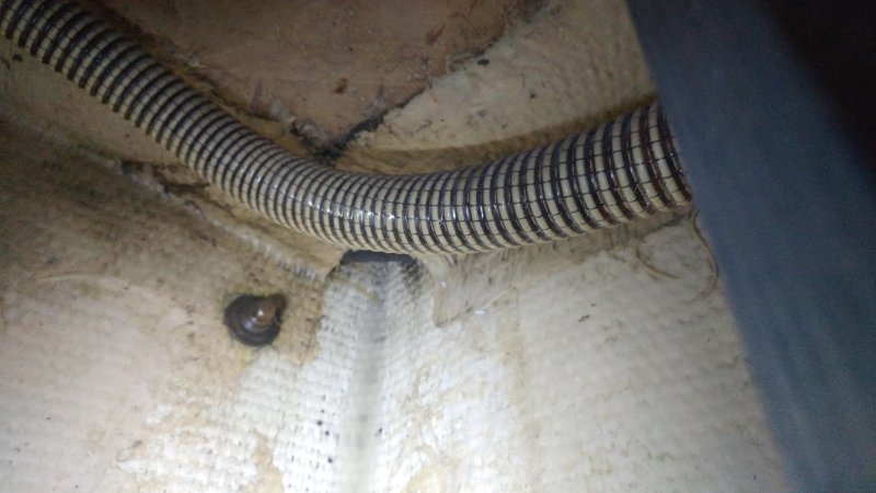

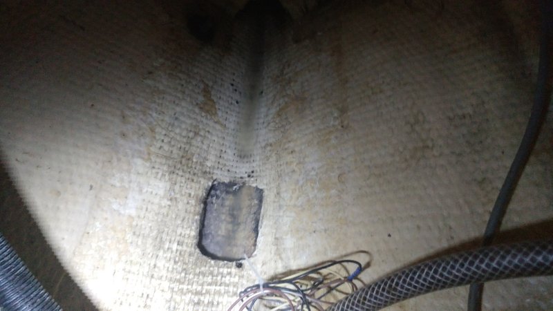

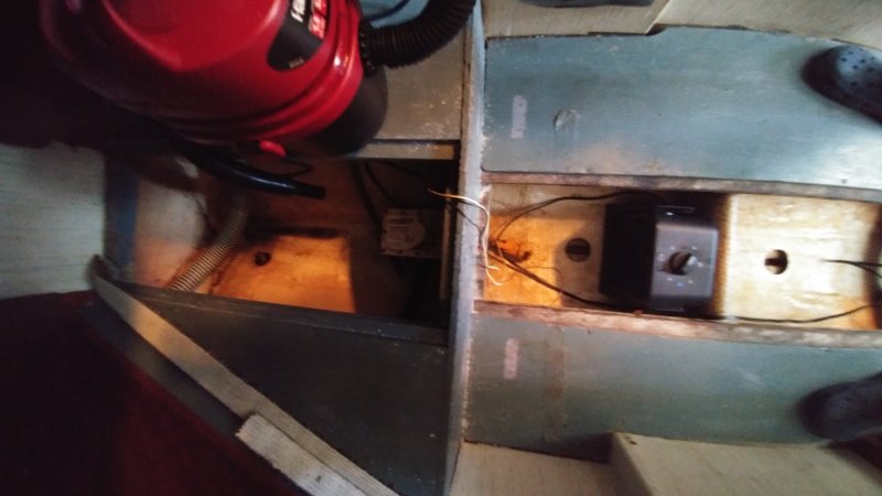

I don't know about others. But when you talk about hollow keel, what exactly are you referring to. On my 75 F32 while resting in the slip. Water always collects in the bow. If I have 2 inches there, there is nothing at the bulkhead to the engine compartment. People have talked on here about hollow keels before. Always believed they were talking about a false enclosure of the keel at the bow. Which I have. but three holes about 3 inches in diameter have been cut into this at the centre of each of the three stringers between the raised portion under the bed and the one that divides the dinette and the kitchen flooring.

I do, but it is accessible. I have lowered the forward bilge pump t fit in the most forward hole.

Sorry, not at my boat at present. I have 3 holes about 3"s each starting about even with the steps, forward to the singer at the birth. Distance about 6 tp 7 feet.

This is a view of the holes that I mentioned in a previous post.
F32 Fly 1975

thanks for the pictures, boat coming out next week... gonna get water out before winterizing

Actually created a new hole up front and lowered a bilge pump there.

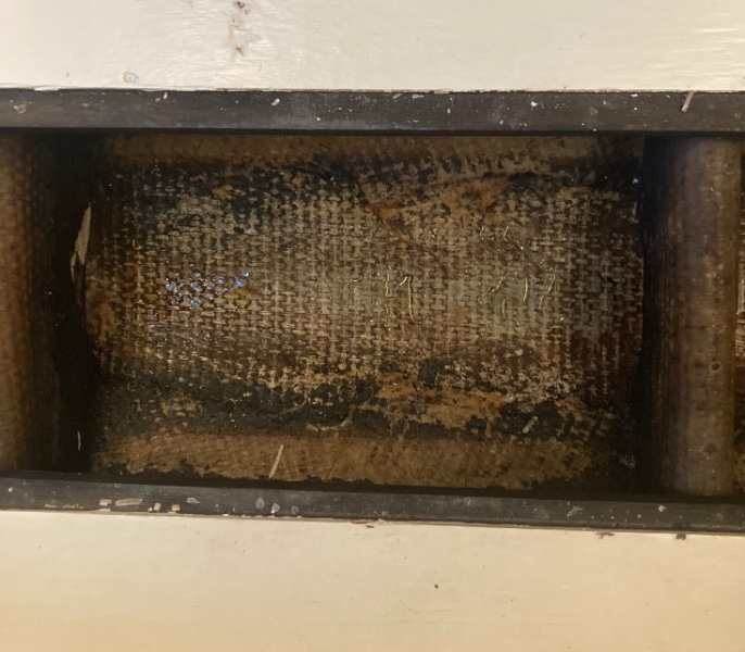

Post by Briank117 »
Am I correct that the “hollow keel” is under this glass matting?
And yes I know it’s filthy—My apologies!
If so, how deep is the keel/void?
