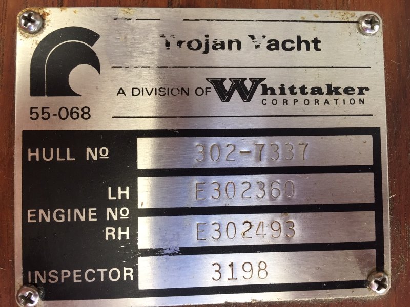

460 or 461 a model # on the ID plate likely on the AC elc. panel also the last 3 numbers on the ID on the transom I can also tell by a photo. The 6.6 is not real common in marine use(yet)
But there are some. Who's conversation are you thinking about?
Heres a sample of the panel plate.(302 is the model on this one)
Trojan id plate.jpg (121.94 KiB) Viewed 15141 times
