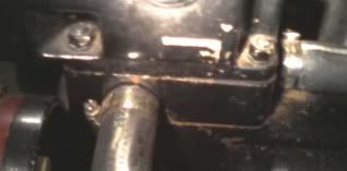

I'm interested in knowing if your exhaust system has spacer blocks just above the manifolds. Mine do. I believe we have the same engines, Merc 255's, GM blocks. I have all the parts/pieces to replace the manifolds on both banks of my starboard engine except for these blocks.
As you can see from this picture, water hoses attach at 2 sides. I believe 1 hose is a supply, the other a return. I'm raw water cooled. I'm hoping to locate these blocks thru John at Marine Tech, who is searching for me now.
If anyone else out there knows where I can get these, please let me know.
