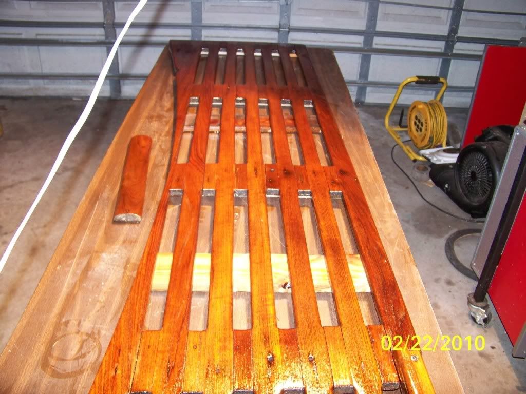

Post by Rodman »
I just got done with my swim platform and railings .

How many coats? That looks great. I put on three coats of Cetol on my swim platform and it only lasted one year so this year I'm going to lightly sand and repair the bad spots and put four more coats, maybe that will do for awhile.

5 coats is what I did on mine... seems to be holding up OK after one season.

Post by Rodman »
I put on two coats then sanded and apply two more. top side, under one two coats

With about 4 coats I get 3 seasons out of it. This fall I did light sanding on some chipped spots and added 2 more.

Man is that gonna be pretty.

Looks good!!

Beeeeutiful! I redid my teak platform with 4 coats and final with anti-skid added. It's lasted 2 seasons and looks good going into the third. I'll sand and touch up and rough spots. Really like the look of Cetol Natural. Not as orange as the original
