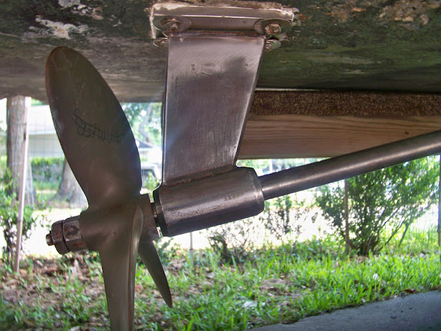

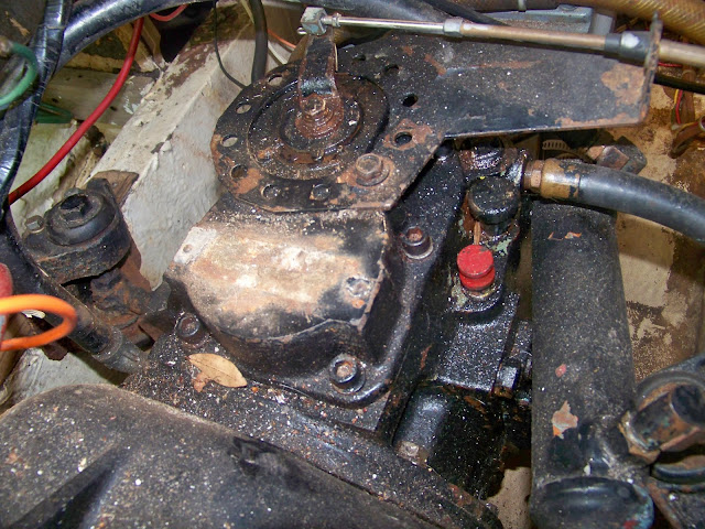

Photos of V drive and Strut

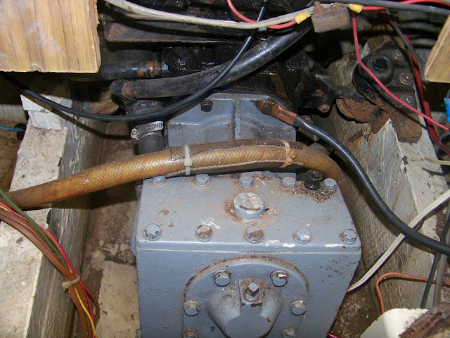

Looks like mine except mine are blue.
I got this info off of a google search for Paragon V-Drive Ratios
PV 31 - 1:1
PV 32 - 1.5:1
PV 33 - 2:1
I have the PV31.

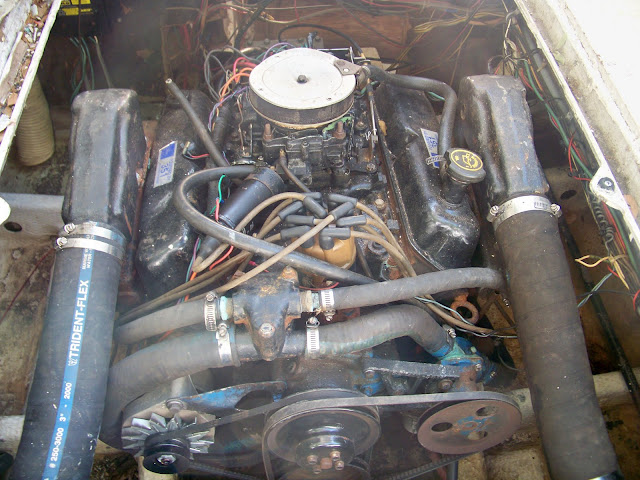

Here's a few pictures when from when I replaced the engine.
http://i853.photobucket.com/albums/ab96 ... C00144.jpg
http://i853.photobucket.com/albums/ab96 ... C00142.jpg
Those pictures were taken back in 2006. Man, it's amazing how 4 years of marine environment will rust up somethings.

Thats is what I have is P31-1 so it is a 1:1 ratiovabeach1234 wrote:Looks like mine except mine are blue.

Rodman,
Looking at the first picture in this post of your prop & strut, I noticed that you have the prop nut and the jam installed in reverse order. In this application the thinner jam nut should be installed first followed by the larger nut. When the last nut is installed and tightened, it takes the load off of the first nut installed and since the larger nut has more thread area its better suited to accept this load.
