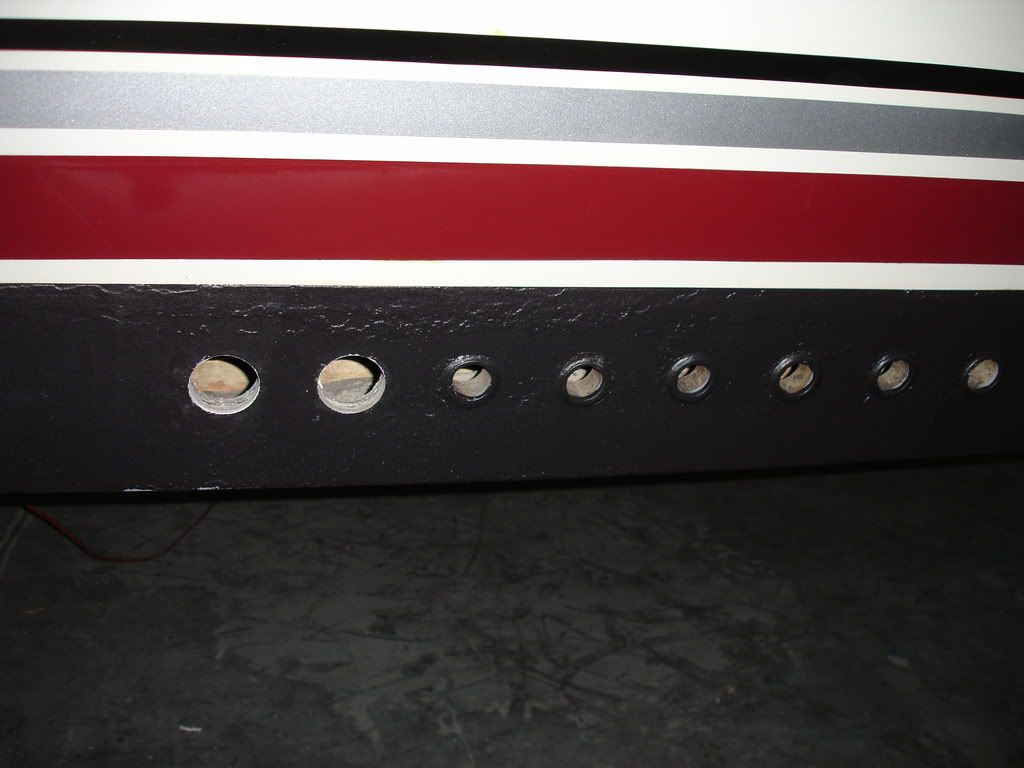

This is an EASY and INEXPENSIVE fix that also allows you to keep the integrity of the original design.
I did a refit to diesels in 2005 and borrowed a tool from John Leed at Marine Tech that allowed me to enlarge those openings.
The diesels are no louder than the 454s they replaced.
Here's a look...
