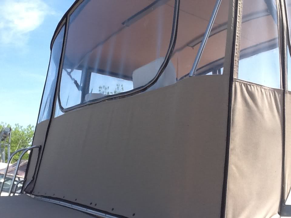

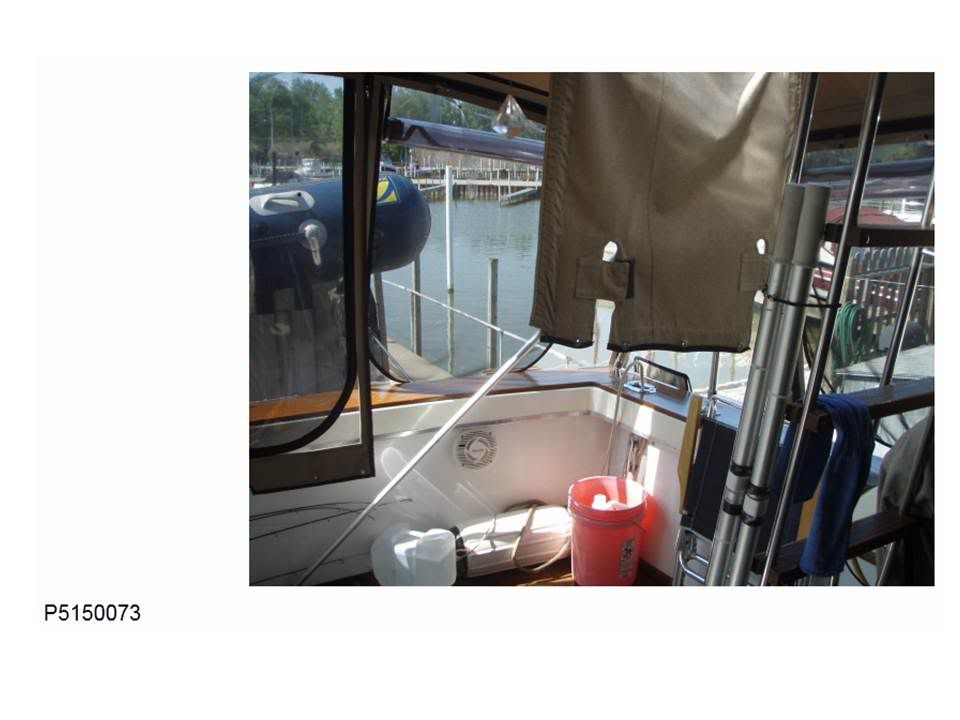

here is best pics I could find... the canvas hangin down is what covers the ladder transition. Will get better ones this week.
Canvas shop will look at it end of this week.... but I have some seams that need more attention.

You need to have a soft rubber seal stitched to the canvas where it goes around the rail... which will work for all but heavy downpours providing that it is the highpoint of the aft roofing.
Your canvas guy should know what to use.....
We use heavy duty Velcro to go around tubing on the T-Topless Spray-Shields we manufacture. Seals them nicely.
A good canvas shop can add these easily ...

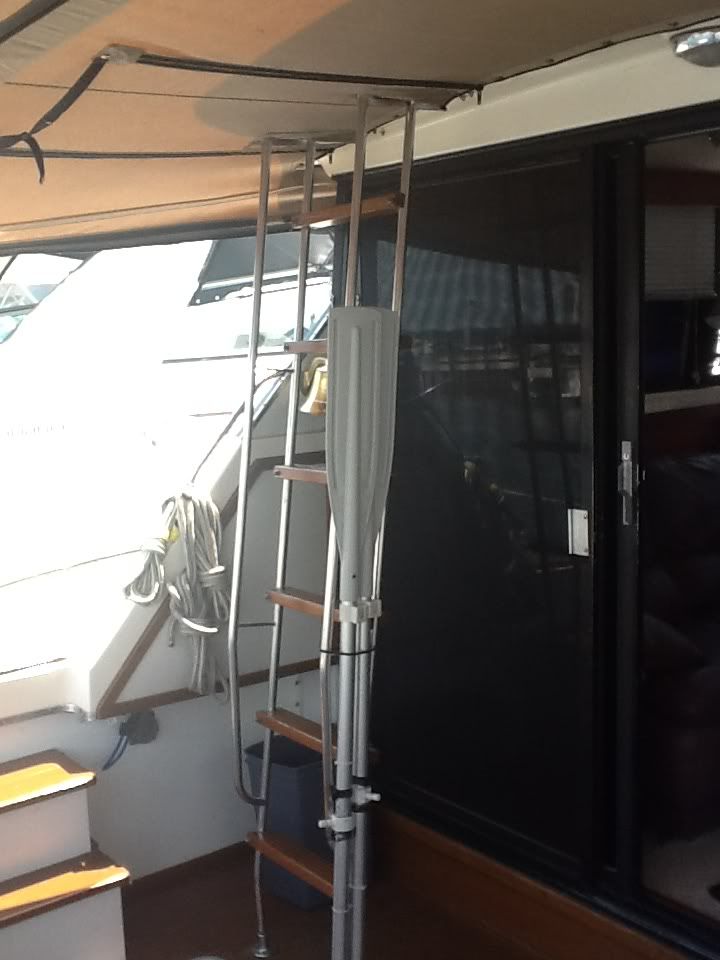

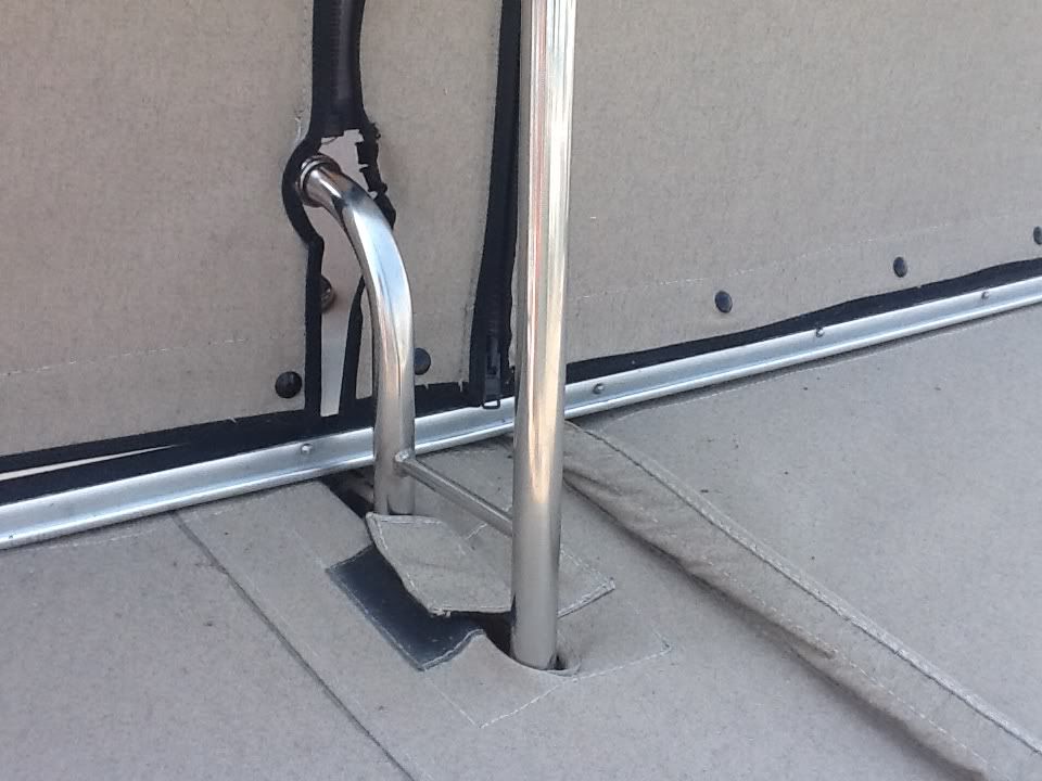

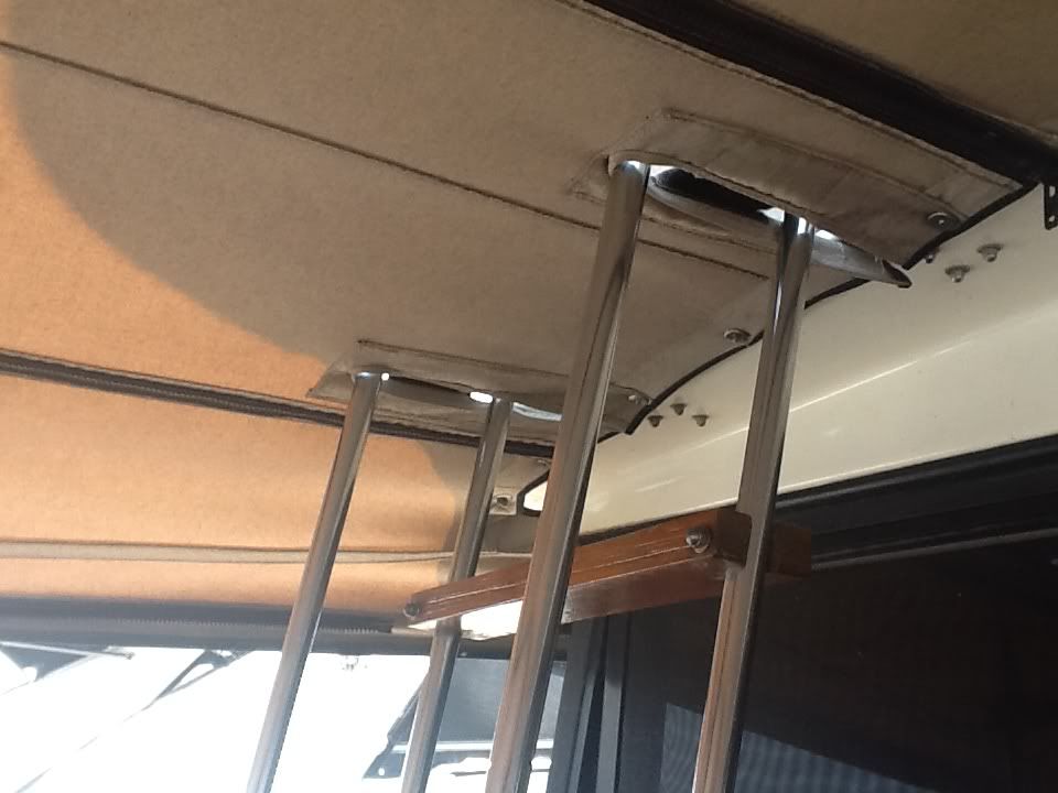

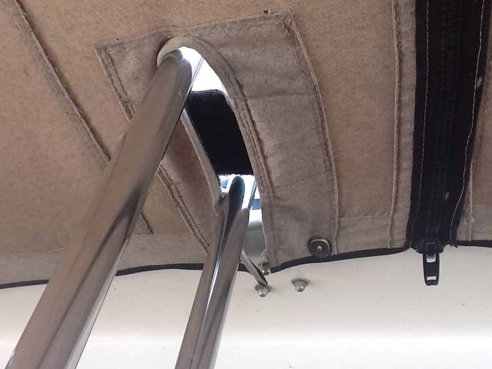

better pics of my situation. Got to busy enjoying the hot boating weather and put this minor issue to the side.
AND AT THE TOP looking at the transition to the flybridge
thanks for the advice so far.
