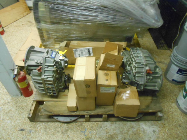

Anyway, you guys have been very helpful, and have confirmed these packages are not the best choice for an F32. At the very least, I would have to buy different tranny's, as these are 1.99:1 with up-angle output (What's with that anyway? V-Drive application maybe?). As mentioned by someone, with the small prop constraint on an F32, a shaft RPM of around 2400 is necessary for a 20+ kt cruise.

up angle ? most ZF are straight or 8-10 deg down a A after the number means down angle .

Angle looked weird to me too. In the image, you can just make out the angle on the tranny on the left. I looked at them in person, and the output flange definitely angles up.
