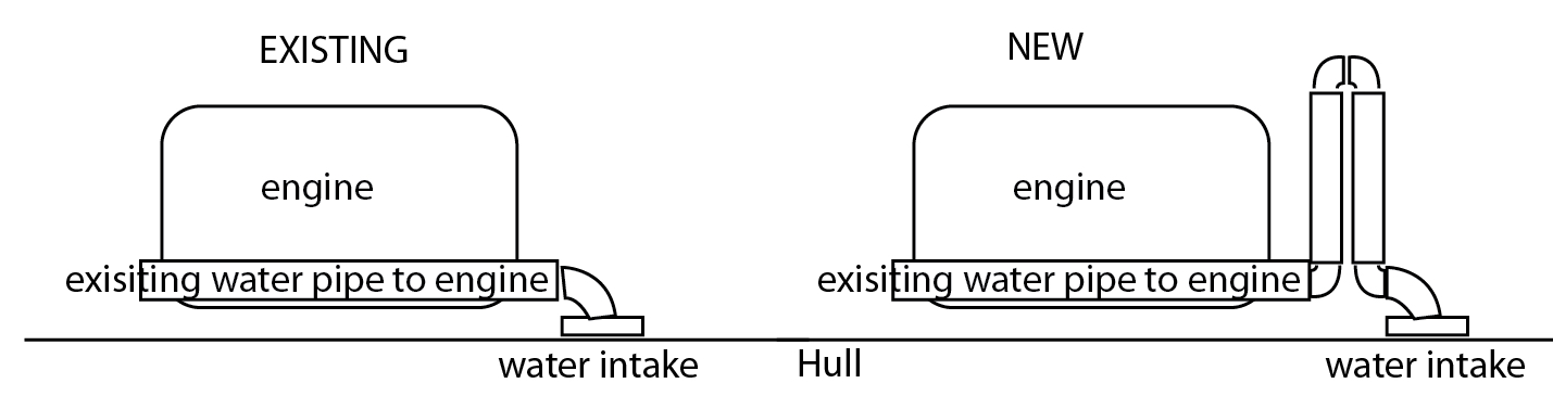

the bottom seacock where fresh water comes in, connects to a hose which looks like it stays low and enters near bottom of engine (correct me if I am wrong)
I was thinking of adding a hose from seacock that raises up to top of engine where it is easier to add antifreeze, and then when done, this pipe would connect back down to the existing pipe at bottom of engine. Do you guys think there is any issue with the engine water pump lifting the water up 18 inches or so and then going back down to floor again to existing tubing.

Svend wrote: the bottom seacock where fresh water comes in, connects to a hose which looks like it stays low and enters near bottom of engine (correct me if I am wrong)

A better approach would be to add a safety seacock adapter to your existing seacock ( http://www.discountmarinesupplies.com/V ... hgod8nADeA ). A safety seacock allows you to close the seacock and attach a garden hose to the engine inlet hose. To run the engine on the trailer I run a garden hose to the engine with the seacock open. I then turn the water on and the water starts coming out the bottom of the boat. I then close the seacock and quickly start the engine. I've been told that if you have the garden hose water running with the seacock closed for too long before starting the engine that the water can back up into the engine (which is bad).
To winterize the boat, I have a garden hose fitting with a barb adapter ( http://www.piecoweb.com/us/garden-hose- ... hgodFtsBvg ) attached to some Tygon tubing. I put the Tygon tubing into a 5 gallon bucket filled with pink antifreeze. The engine suction pulls the antifreeze into the engine. The safety seacock adapter makes life much easier.
Is the impeller the pump for fresh water intake?
I would not , it would be easy to get a air lock and it would add restriction to the intake . look at the other 2 posts above

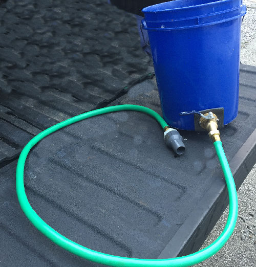

4) I created a simple pail set up with short hose to add coolant. (see attached image). It is simple and cheap to make. NOTE: on my engine setup, the engine sucks the full pail of anti freeze very fast, so have the pail filled, and a few extra open and ready to pour!
