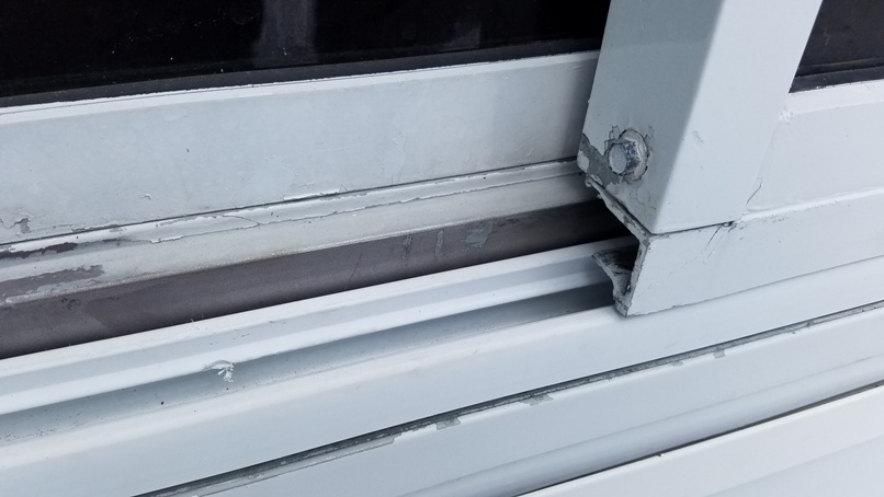

prowlersfish wrote:captainmaniac The photo in my post is from your boat . Was the L bracket added ?

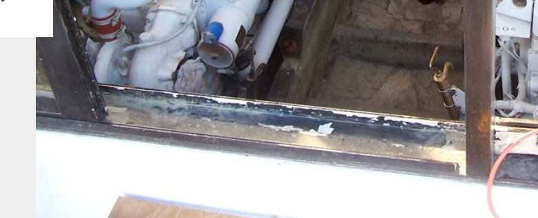

L bracket was original as far as I know (at least has been there since I bought the boat 16+ years ago). Don't think it is unique as here is a shot from the forum re F36 gas to diesel conversion that shows the same L bracket. http://i235.photobucket.com/albums/ee26 ... 0_0585.jpg

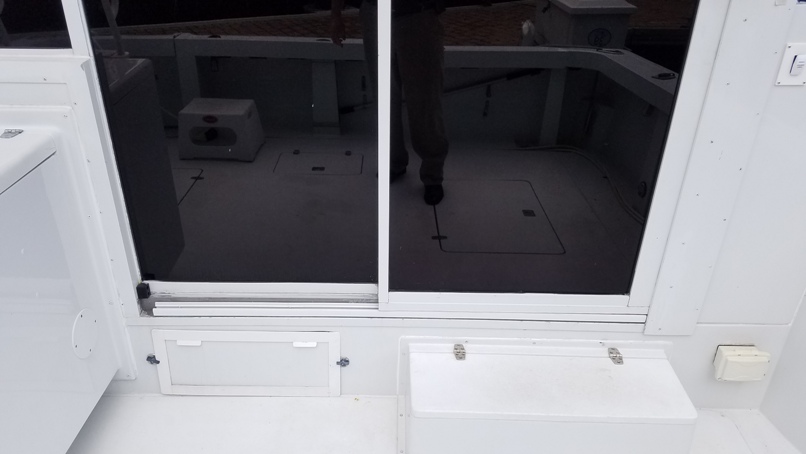

Re: F36 Convertible Sliding Door Track
Post by El L Sea »
WayWeGo wrote:
El L Sea wrote:The picture of the door frame (1st pic) is from the side on my workbench. I actually just slid the bottom part of the door off the glass and everything so I didn't have to haul the whole door home. The bottom picture shows the actual orientation.
The photo without the glass threw me off -- now I understand. How did you remove the existing track, or did you put the new track on top of it?
Thanks for the suggestion, I will think about all these when I can actually get back to the boat and see what fits the best.
I actually pulled the track and replaced it. I took some pictures today. Not too many since it was 85 degrees outside :D
El L Sea, thanks for the photos -- that is quite helpful. Not sure I could do exactly what you did since there are three parallel tracks that are part of the same extrusion on our boat, and there are fixed panels in two of them.

prowlersfish wrote:I don't see the L in the photo but its not a clear shot that I saw . I will take a photo of mine this weekend ( if I can remember ) BTW Do you know what Happen to Danny ?
Here's a zoomed in version of the picture, and you can see the L bracket stopping an inch or so short of the door frame on the stbd side. I am guessing it's purpose was to stop as much cockpit gunk / dirt / leaves / bugs etc as possible from blowing or washing in to the wheel track.
L bracket.jpg (39.88 KiB) Viewed 7434 times
Have no clue what happened to Danny. Never knew him. Just found that picture by doing a search for "F32 sedan salon doors" or something similar.

Capt M. I had looked a a photo with his gas engines still in and it kind of looked like mine . BUT it from the inside and very unclear . In the photo you posted it looks a whole lot different then mine and yours too .Yours looks like a cross of both. Notice all the glass was removed ?
What year is your Boat ?
Waywego's boat is a 75 mine is a 77/78 and Dannys is a 80 and they all are different . Makes it interesting for sure. :shock:
Are all OEM Trojan or have some of ours been changed ? I do know they went to a offset and wider door in the 80s along with a latch/lock change . Maybe a different door company ?

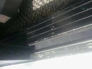

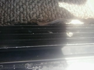

This what my track looks like . The door roller rides on the raised rail .
door track.jpg (19.79 KiB) Viewed 7294 times
door track 2.jpg (21.12 KiB) Viewed 7294 times

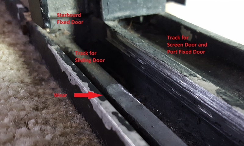

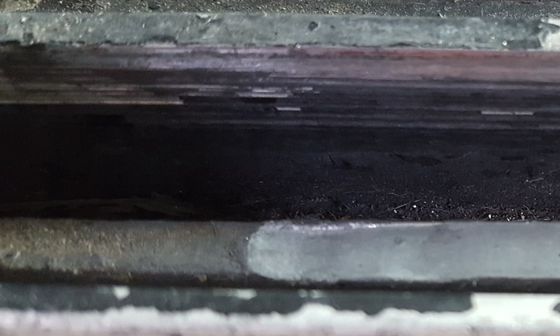

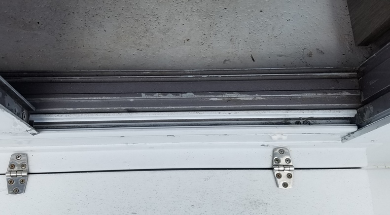

Here are a couple of photos of our door track. The wear at this end of the track is much less than at the other end.
As you can see, the top of the rail is basically flat. What you cannot see is that the rail for the screen door is identical to that of the sliding door, except it has no wear.
My play is to machine off some material from the top of the rail and replace it with fresh aluminum or stainless steel.
Door Track 1.jpg (111.31 KiB) Viewed 7283 times
Door Track 2.jpg (120.81 KiB) Viewed 7283 times
