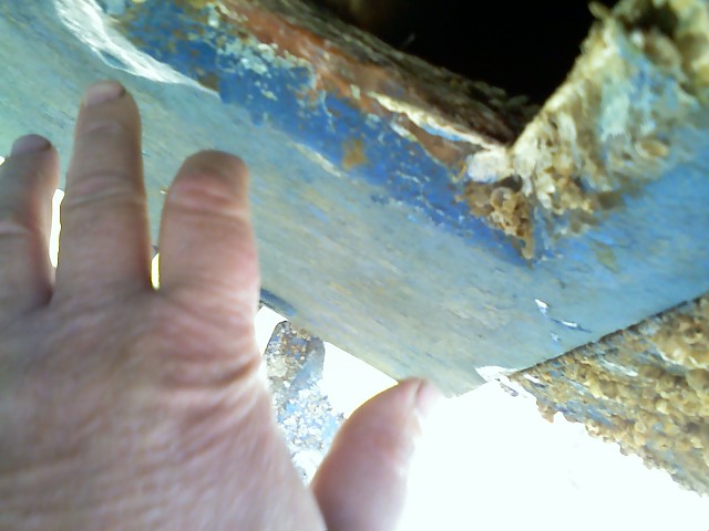

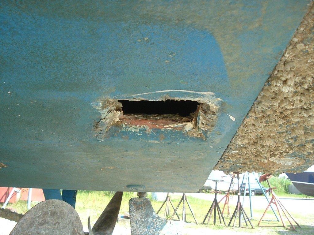

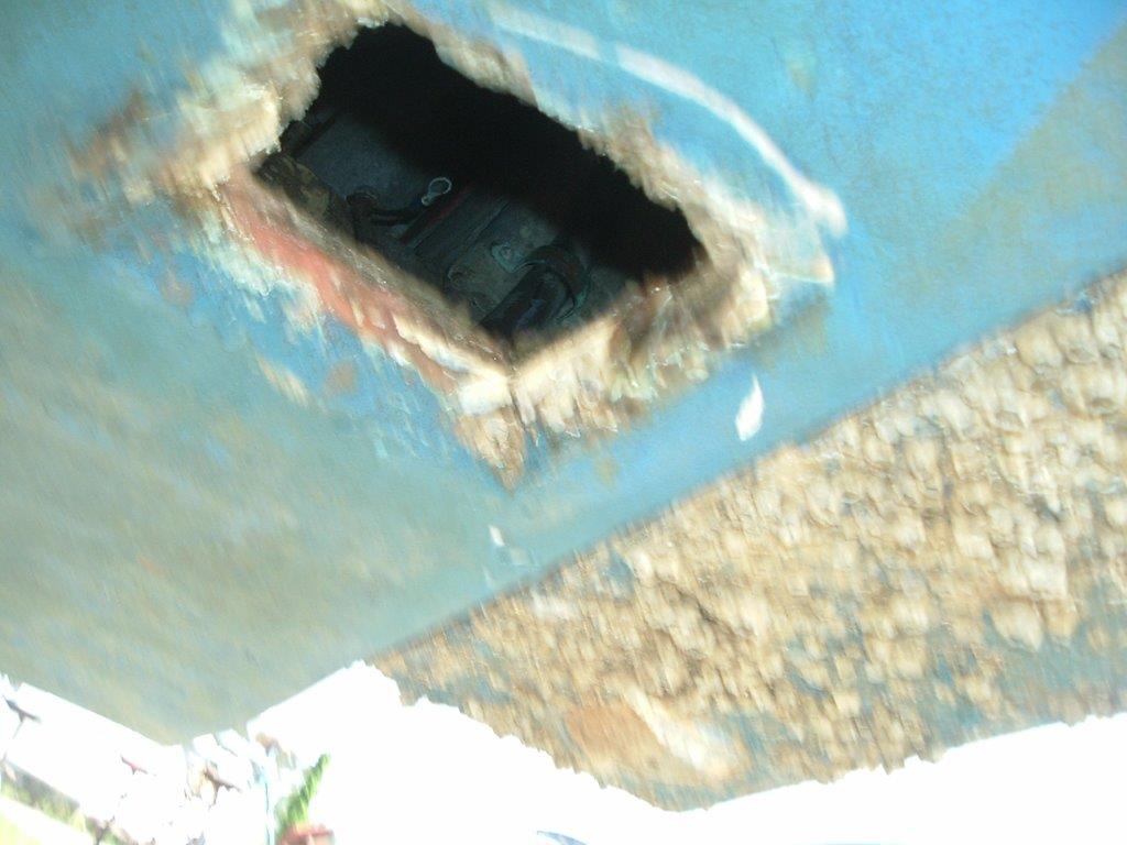

Posts: 12732
Re: Rudder bearing removal
oil&water wrote:At one point I was waiting for the whole rudder mount to drop through the bottom of the boat. It was not a good feeling at all watching the entire back of the hull shutter with each hit. Old barnacles were falling off the vibrations were so intense. I have a whole new respect for fiberglass' strength.
Look at that area real close . It is the weakest point in the hull , yet its under stress . A bent rudder shaft can flex the hull to the point failure .
Posts: 12732
4"X6"

oil&water
Posts: 245
Post by oil&water »
Wow! That is a sad sight. I will examine that area very closely. I've seen so many boats go down due to rudder strikes.

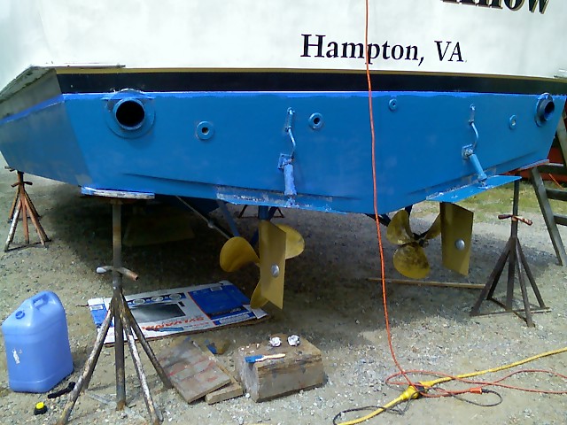

Posts: 12732
It can be fixed
