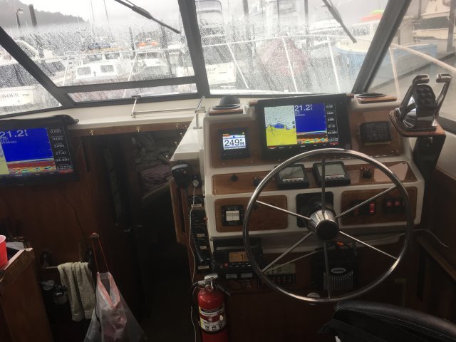

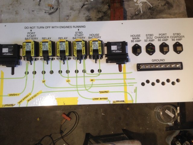

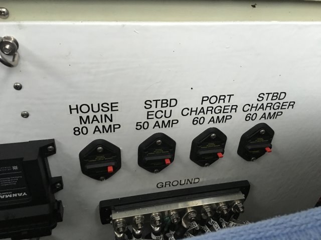

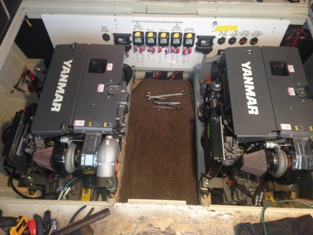

Blue Sea products worked well on the Instant Fun
- ENGINES IN.jpg (65.99 KiB) Viewed 9845 times
- Blue Sea.jpg (57.73 KiB) Viewed 9845 times
- IMG_6965 (1).jpg (56.14 KiB) Viewed 9845 times
- IMG_1529.jpg (42.89 KiB) Viewed 9845 times
- IMG_1528.jpg (56.91 KiB) Viewed 9845 times
Yanmar 6BY3-260's
Yanmar 6BY3-260's

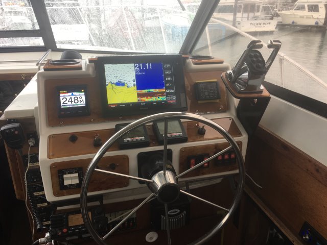

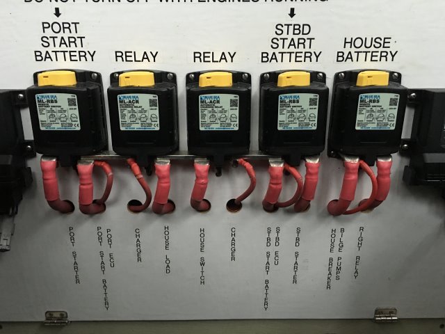

Re: Battery configuration
You can see the Blue Sea remote battery switches to the right side of the helm, behind the wheel.
- MAY 2018 (17).jpg (58.28 KiB) Viewed 9845 times
- MAY 2018 (15).jpg (59.21 KiB) Viewed 9845 times
Yanmar 6BY3-260's
Yanmar 6BY3-260's

This looks so very GOOD!!!
no
AWESOME !!!!!
no
AWESOME !!!!!
David , I wish my wiring looked a 1/10 as good as yours . Nice
Ok. So we need to talk lol. Id love to pick your brain in your configuration. Like what does the ECU stand for? Why so many different relays? Does relays mean the automatic charging relays or actual relays? We can move this to a private message if you like. Or if phone text is easier please let me know and i can PM you my cell.
