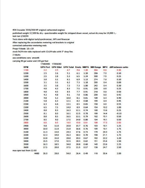

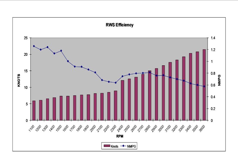

Attached below is the flo scan results of my 4 blade props with the gas engines before the diesel refit
Really not too shabby when one considers the actual VOLUME of this vessel.......

RWS posted some good info. I will say his speed numbers are better the most, but he keeps up his boat better than most.
