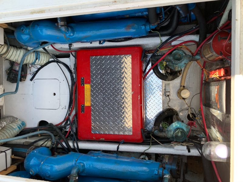

not sure if this is of any help
I can stand on it no problem
battery hold downs are part of the cover
10 meter mid cabin

mrrudely wrote: Thu Jan 05, 2023 10:52 pm not sure if this is of any help
rr,
Now that's a different way to do it! Is that a diamond plate screwed/glued to the top of the original cover? What about the piece of plate that seems to be along the bottom, what does that serve? I like the set-up for sure.

diamond plate is aluminum glued down
I think stainless would be a better choice
the bottom piece is cosmetic covering some wood structure that was there
makes for a good step

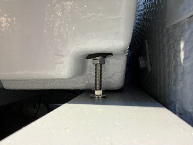

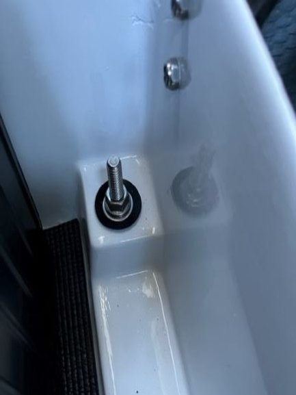

I posted this on the FB forum, but haven’t received any response to date. As I mentioned in my original post, I’m refreshing the battery box and grounding bus. I’ve ran across a question for some of you regarding the securing of the battery box to the planks between the engines. The PO had just screwed it into the planks with no regard to the “step” on the box at each corner. It seems like there should be bushings or spacers of sorts to prevent overnighting and cracking of the box corners. So, my question is, what does your install look like and or how was it originally designed?
Pictures of my setup are on the Official Trojan Page on FB, photos are too large to upload here at the moment.
Thanks for any input.

You could make bushing or spacer. Or just don't overtighten

Moderator wrote: Mon Mar 27, 2023 11:17 pm You could make bushing or spacer. Or just don't overtighten
Make a spacer, should be easy and no worries.

Post by Scott67 »
Just a follow-up on what I decided to do regarding the spacer. Seemed easy enough, I just needed to think about it some.
