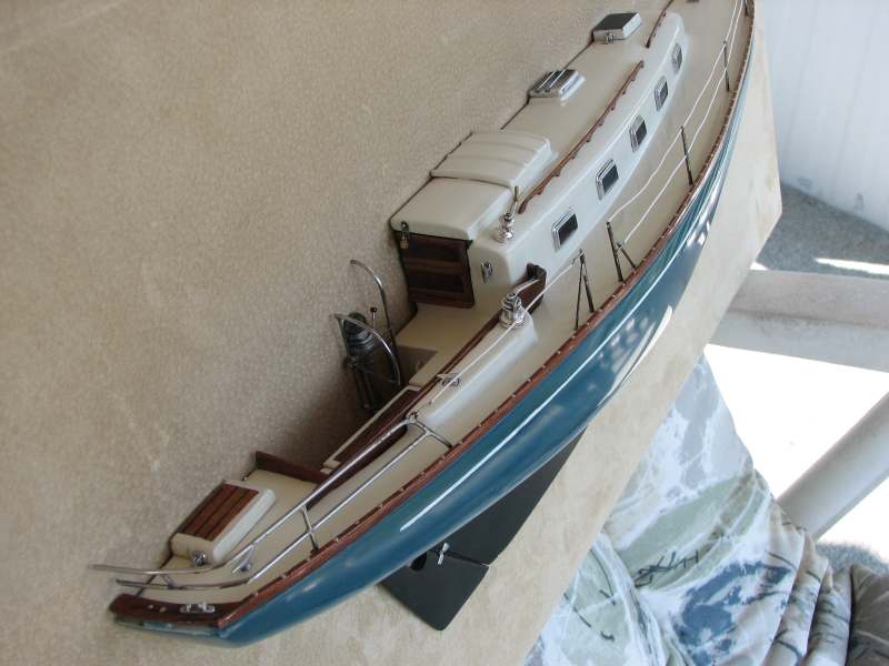

Anyway, you get the idea ... need to be creative when scratchbuilding. I've built a lot of model racing cars, Flying Scotsman loocomotive, several sailboats including our own Alberg 37 (below) ... yes I'm a sailor!!
Frank

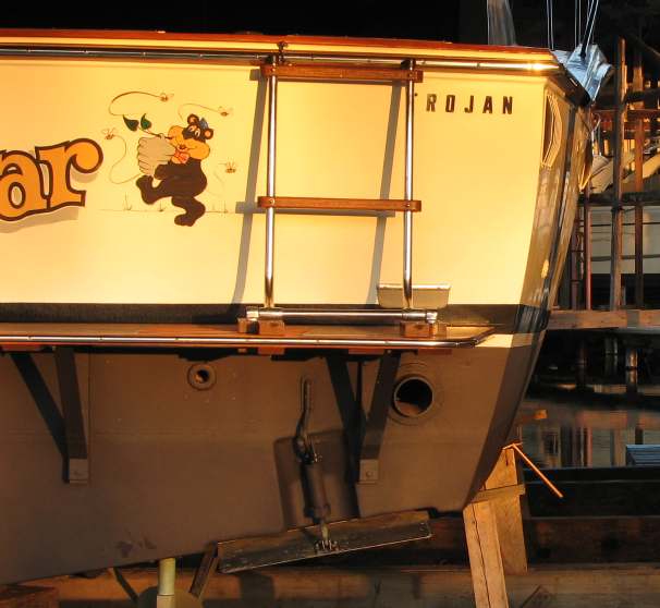

I just know you're now going to ask me "where's the little ladder on the swim platform?"
F
His boat doesn't have them. An early 70's model.
