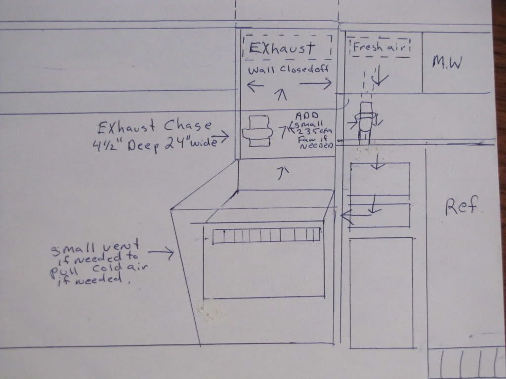

prowlersfish wrote:Another Idea would be a portable type A/C unit that uses a hose to vent the hot air out side . This would do exactly what you what at a cost just a little more then a window unit. The only draw back is it may take up too much room . You may not be looking for advice But I would hate to see you do all that work only to have something that won't work . I have seen window units installed in boats ( I have done 2) . I have seen them done in ways you would not believe , some work some do not.
this is the type of unit I am talking about that vents outside you can find similar types at Lowe's and home depot and many other places
http://www.air-conditioner-home.com/Sol ... -07R-62DB/
This is not the first time I have done a project that was met be such scepticism and Im sure it wont be the last,
We rehab ed our wood dead rise I was told I could not use water based paints , they will never hold up I was told time and time again by all the waterman who have owned these boats for years,I was making a mistake after extensive research and planning , I pulled the trigger . putting on a 100% acrylic emulsion roof system on the top of the helm and cabin and brought it down tied it in under the rub rail and painted the rest of the hull above the water line in acrylic latex house paint, now I just sit back and laugh as they all are out there repainting their boats and fixing leaks from their roofs , and we pressure wash ours and touch up and it looks like I painted it yesterday,
I never do a project with out extensive research this one is no different
I don't not get discouraged because some one else has tried and failed
I make part of my living taking on projects other contractors say cant be done so its not my first rodeo, the risk reward factor is heavily weighted on the reward side I already had built the chase wall as part of my dinner rehab I already have a circuit there for the unit, taking
out one drawer is no big deal could use the teak where I cut out the starboard closet I can pull in and out 235cfms of air for about 2amps so its hardly a problem
I will know in a hour of use with a heat gun on weather or not the compressor is running to hot,
Its not rocket science :D

thank god I am not a architect or I would go broke
but this shows the plan we will know in a couple of months the fate of this project if it fails I will be glad to stand up and say it was a idea that did not not work no such thing as a bad Idea :D
heating and cooling reverse cycle hi efficiency self evaporating unit if I can find one that small
like this but with rear discharge
This 7,000 BTU window room heat/cool air conditioner is designed to cool approximately 280 square feet. That's a 14 ft. x 20 ft. room! 7,000 BTU (cool) & 3,850 BTU (heating). Fits windows 22 in. to 36 in. and 14 in. H. Energy efficiency rating 9.7. Features: 4-way air deflection; two cooling and two fan only speeds; remote control. 5 year warranty covers parts, labor and compressor. 115 volt.

It's not the compeser I worry about its about the the hot air from the back of the unit(condenser) if it is not removed then the unit can not transfer the heat and therefor can not cool . if you have plenty of air flow it will cool if you don't it will not very simple , your engineers statement that all you need is a small vent( for the out side) is what worries me . and leave me with worries about his training in HVAC , of course his idea of a small vent maybe a lot larger then mine .
looking at your drawing it will work but only if you use a fan/bolower to exhust the hot air
Don't forget away for the unit to drain .

prowlersfish wrote:9rock
Small vent i am referring to is on the side of the unit if I have to dial in the unit ,not exhaust vent I have a lot off room for a vent in the hull and chase is 4 1/2 deep x 24 wide so there is a lot off room for hot air to escape , and I can add a blower fan as in my drawing to aid this if need be . one slightly smaller on the intake side for fresh air ,
I saw a refrigerator compressor unit in the west marine catalog that had a transfer box built on the back and a 4" flex duct attached but my chase offers more volume of airflow , the unit is self evaporating no drain needed in theory it works whether or not it works in real time we will know soon enough wont be the first failed project and I am sure it wont be the last since I like a challenge and now that I have been told I am stupid I am even more driven to make this system work :D

prowlersfish wrote:9 , I never said you were stupid .
I have not heard of a self evaporating window a/c
I was not referring to you , I have not found a self evaporating unit that small yet ,smallest I found was 13k btu but draining is not that big of issue if need be
I have the unit they had in the bulk head I can take out the top support for the drawer and drop it in with no cutting its a 5k sufficient for the cabin area so i will test that if i dont like the results i will go to a portable unit and duct it out thru the same chase no harm no foul no money lost
