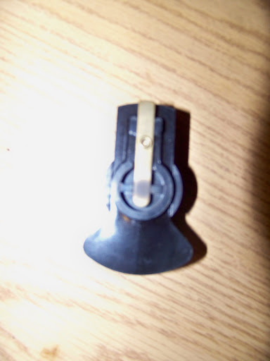

You have to understand I never thought this could a problem. I replaced the wires plugs and everything inside the distributor right after I got the boat home. Even before I put her in the water. Well after reading AbsterMcgee last post I went and check. This is what I found. I believe the cap is the wrong one for my engine. In the center of the cap where the Coil plugs into does not spring up and down. Its been arching from the top of the cap to the rotor button on the distributor. I will post photos to show what I am referring too. I will go in the morning buy the correct cap see what happens. This could be the reason I burnt up two Coils also.

by prowlersfish
or the rotor is wrong ? or both ? make sure you get marine stuff . some auto stuff looks close but many times can make a big differences you will need the brand name off the dist , Merc used 3 different brands incl their own .

prowlersfish wrote:or the rotor is wrong ? or both ? make sure you get marine stuff . some auto stuff looks close but many times can make a big differences you will need the brand name off the dist , Merc used 3 different brands incl their own .
Rotor make look funny thats because it came with that Ignitor I bought.
