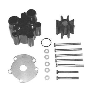

wowzer- thanks for the info on the pump and merc parts number. Gave it to my local dealer and was able to get it put on today and let it idle in the yard with a hose attatched to it for about an hour or so and didnt get above 140, so going to get er wet tomorrow.

FYI - SIERRA makes replacement Mercury/Mercruiser parst (as well as many others). Their quality is top notch, and this impeller kit is only $58 list.
Sierra p/n 18-3150 Impeller Kit for Mercruiser Bravo I/O, Replaces 46-807151A14
$57.97 http://www.sportsmansguide.com/net/cb/S ... tid=440808
$59.95 http://www.marineengineparts.com/shopsi ... ge310.html
Mercruiser p/n 46-807151A14 Impeller Kit $105 list price
