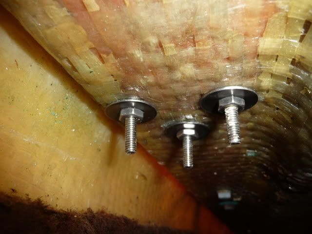

I removed the bow rail, all but the aft bolts where it meets the deck,
the underside of the for deck was wet. I believe a few of the stanchion bases were leaking but the real culprit was the holding tank pump out deck fitting, The clown who installed it used # 8 wood screws and not enough sealant to close up a knats ass.
I am pretty sure this is where the water was coming from, it is mounted directly above a side stringer which would allow water to run forward, down and back to the vee berth stringer support.
I came to this conclusion after removing all of the side panels, I gained access to every stanchion base. the underside of the for deck was wet, but more like condensation, not from leaks at ethe bases except for three.
I sprayed all of the bolts with penetrating oil and then removed them all,
I had several break immediatly, the bolts were almost corroded through, at that point I decided to remove all of the bolts and replace them. what a job!
the hardest bolts to access were the to forward stanchions as the nuts were in the chain locker, I'll definately be sore tomorrow after those contortionist moves!

removing the stanchion, there was a "gasket under each base, however, the gasket was cut out for each bolt, allowing water to enter if not bedded correctly
cleaned
taped and silicone applied and skinning over
applying silicone to the screwes and counter sink in the base
screws in and snugged up (not tight yet)

I replaced all of the brass (or bronze) hardware with 316 stainless, I also added 316 SS fender washers to nut side of the bolts to add some backing , the originals did fine for 30 years, and I suppose as a system they're strong, but I was a little surprised by the lack of not only backing plates, but a number of the bolts didn't even have washers, maybe they have been removed since built to try and seal leaks, but if you haven't checked yours, the next time you lean against or over the bow rail, think about # 10 brass or bronze screws with no backing plate and tiny washers....
It got dark on me and it is Christmas eve, but I'll get photos of the new fender washers and the dry underside, I left a fan and a dehumidifier running, but the condensation had already dried by the time i was finished rebedding the rials
I'll also post some photos of the screws that had corroded in two

new hardware and fender washers for a little more backing to the raile base
