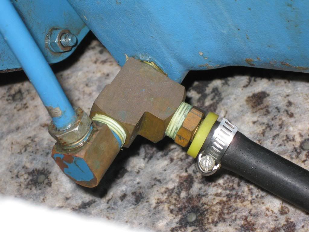

Larry...is this what your talking about?
[img][img]http://i1235.photobucket.com/albums/ff4 ... con007.jpg[/img]
The blue tube is the oil dipstick tube. The brass fitting in between it and the oil pan was added later for the oil change system. The black hose runs to the mounted oil changer pump, which sucks her dry in 7 seconds into a five gallon bucket. But this system is very expensive. I think what your talking about comes standard on most newer merc and volvo inboard/outboard gas engines. It's just a hose that runs from a fitting just like mine about 14" up and attaches to a clip. There is a plug in the end of the hose. But you still have to hook it up to a pump, just alittle easier. Using the dipstick tube to suck it out is fine as well.
Ron
[/img]
Ron

I think that this might help you do what you want to do. I work for a high end car company as a technician and have used these with out any problems for years. We use them in heavily modified cars where the drain plug access is blocked. It is like the t block in the picture posted earlier but is has a spring loaded locking valve. In the picture that was posted earlier there is no valve. If the rubber hose springs a leak all the oil is dumped in the bilge. look at the n series valves the have hose fittings.
