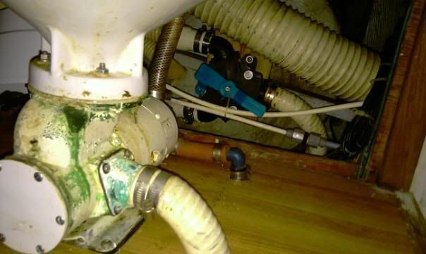

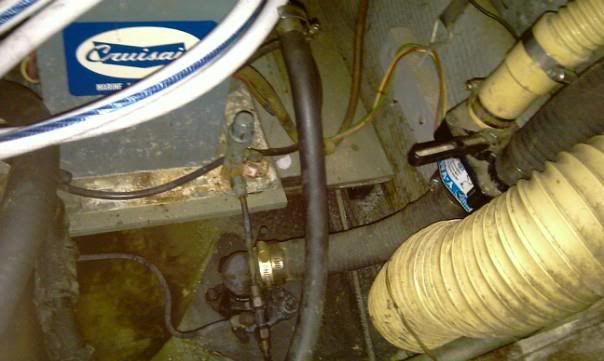

ok so here are the only two Y valves i could find on the whole boat that have anything to do with septic system
This one is of the aft head, right behind the toilet, the Y connects the toilet to the tank, and the other port is just a hose with a plug on it (as i said earlier probably for an overboard discharge)
This image is mid-cabin right under the stairs and to the right of the head (next to the AC unit), from what i could tell all it does is just regulates where the water comes from for the flush.... might be wrong?
