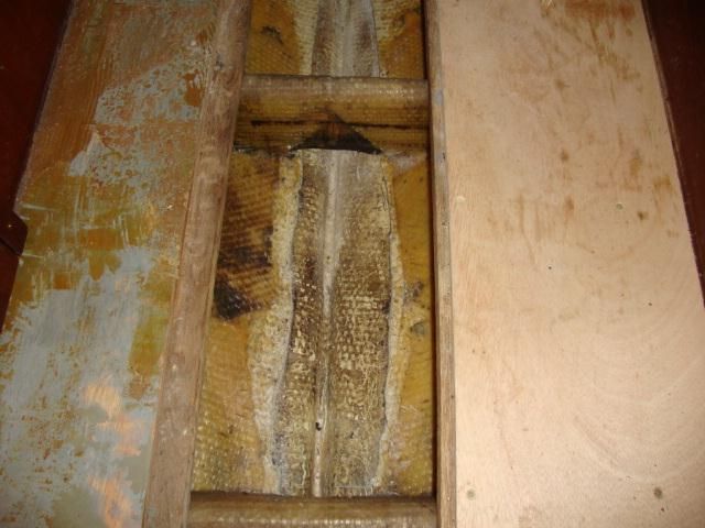

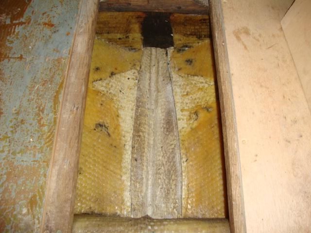

F32 Hollow Keep Pictures

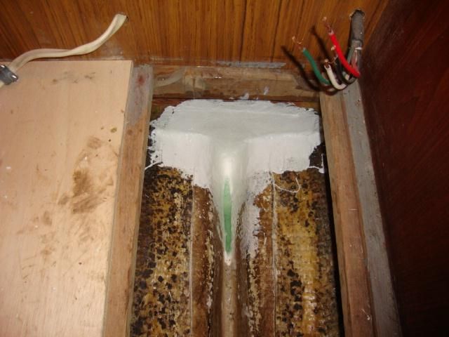

Interesting ...
Did you just glass in the front of the forward part (white)?
Are thes in order from front to back?
1) Under front stateroom floor?
2) Under front of galley floor?
3) Under Galley?
3) Under Galley?

Not exactly sure what you mean. Someone has removed the fiberglass separating the bilge from the hollow keel in these pictures.
Makes sense to me. How thick is it? I can't image it offers much in terms of structural integrity.

Re: F32 Hollow Keep Pictures
I think this picture is aft - basically this is the forward side of the bulkhead between engine room and lower cabin area. There are more pics on CommoDave's photobucket account that show the same bulkhead from the engine room side (you can see the hoses for the vents and just see the fuel/water separators mounted on that bulkhead).rossjo wrote:Interesting ...
1) Under front stateroom floor?![]()

The photo of the bulkhead with the electrical wires sticking out is in the galley looking aft. They cut a piece of marine plywood and glassed it in on fore and aft sides of the bulkhead. I will be putting a bilge pump in the engine room as far forward as possible. The woven roving that was cut out was very thin and must not have had any strength. I have to clean the bilges next spring along with lots of more work. I just retired this week, so I will be traveling to Michigan next May to spend the summer on the boat. I will be putting a bow pulpit with windlass on, a hardtop over the cockpit, new canvas, new countertops, new upholstery, new inverter/charger and many other projects that will keep me busy and out of trouble...
