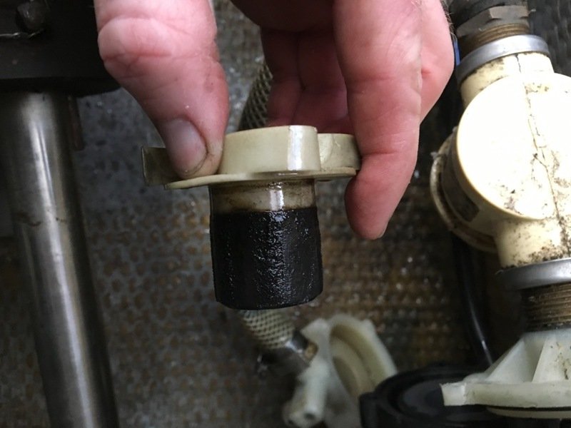

I know the pump is getting power (used one of these to confirm https://www.homedepot.ca/en/home/p.non- ... 64603.html, but obviously can't confirm voltage received unless I pull connectors apart) and I can hear a hum from the pump (but no vibrations) when it should be pumping. Pump is a 'Marine Development Corporation' (likely March) PMP500, 490 GPH at 3' head.
With the wet side cover off I could spin the impeller easily by hand. Could feel resistance followed by it jumping by itself because of the polarity of the magnets. Nothing physically jamming the impeller, and it was not fused to the shaft. It was a bit dirty / grainy around the magnet at the base of the impeller (with I am guessing metal filings or magnet filings...). Tried to 'wash' that at first before I realized what was going on, then used paper towels to wipe as much magnetic 'grit' off as possible. Not a perfect surface when I was done, but not sure how clean I should make it or scrape it without doing damage to the magnet.
Looked like this when I started - messy, but not a total mess:

Cleaned the face of the impeller, cleaned the housing, cleaned out strainer and bowl in case there was a flow issue, also opened seacock to 'flush' incoming line and water flowed freely and clean.
After putting pump back together and opening seacock, when we turn on AC I can again can hear pump humming, but no water flowing through AC. Also noticed a new symptom today -- after about 10-15 seconds of controls set to AC and pump humming, AC breaker (15A) popped. Had it running longer than that last weekend (up to 30 seconds) without breaker popping.

So, at at this point I am guessing the pump motor itself is fried or shorting out (only supposed to draw 2 amps) and I need to replace the whole unit. If it is popping a breaker, it sounds electrical.
Any thoughts / experiences / suggestions are appreciated!

With someone at the controls and you at the pump, have them turn the unit on while you quickly loosen off the face of the pump slightly while the pump is running. Loosen it enough and it should start squirting out at pressure if the pump is working. This is often required to get the pump going first time in the Spring or after it looses it's prime from coming out of the water for one reason or another.
Sometimes with no raw water, it doesn't take long before the system shuts down or pops a breaker. Do the above quickly before the system freezes up. If it does, it won't let water through so you need to walk away for a while then start over.
Make sure you're not sucking air from the strainer, connections, etc.
