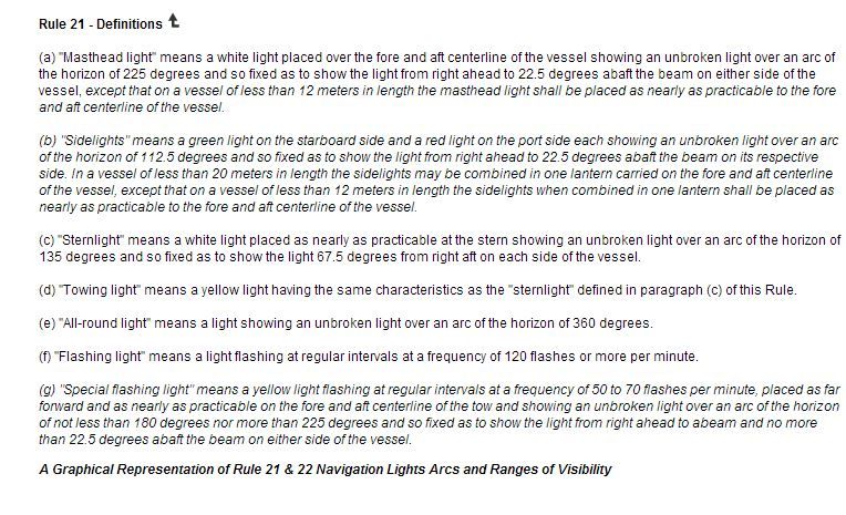

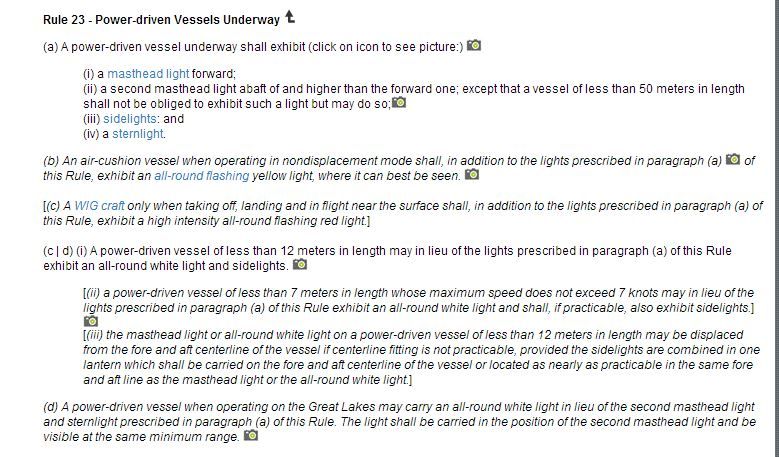

Mike
I think that if you were to be boarded at night by the CG, and they felt like being asses, they could technically cite you for not having the light on the fore and aft center-line, would it happen, unlikely,

I think if the anchor light only was off center, that wouldnt be an issue, the regs are for a vessel under way

Thinking now of fold down mast light off the port side of the ladder. Can make my own mounts and use something like the Attwood 5500 series. Too bad there doesn't seem to be a two pin mount for those that wasn't made to be flush mounted in a deck. Will make my own connector. No big deal. Yes it will be off center, but the reg reads "as close to centerline as practical" :)
