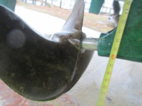

- IMG_7012.JPG (47.52 KiB) Viewed 8842 times
Trying to get an 11 Meter on Plane

Those props look very small to me..... What size are they?
4 blades will help by lifting the stern and I would think you could add 2" to the dia of those.
Maybe RWS can comment on the size of his.

RWS mentioned a test report of a boat with 24x28 props... They look smaller to me, what size are they David?prowlersfish wrote:Unless Its turning to much rpm I would not add 2" of prop . Not the same boat or engines as RWS
From comments here it seems something is wrong to require down tabs to achieve plane......
Either the engine power is way down or the boat is ass heavy or the props too small or ..... any more?

I looked back at my survey and it says that they are 24x28. I looked thru the pictures to see if he had a picture with the tape measure on it and the picture is very blurry but it looks to be be close to that best as I can see.
