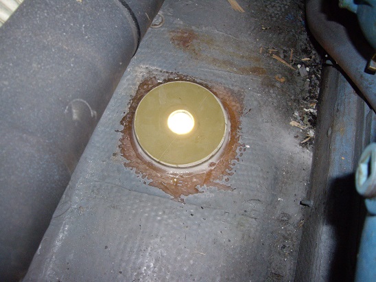

I spend the weekend at the boat doing more of the work. I prepped the hull fibreglass to receive the backing plates. All 7 of them...
Here is the starboard raw water engine cooling inlet.

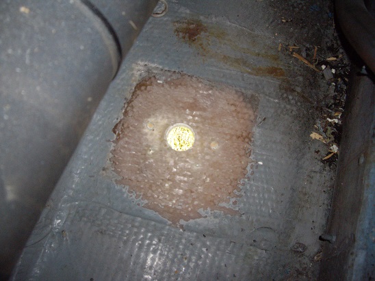

I then glued the plates with West System epoxy and 404. Again starboard raw water engine cooling inlet

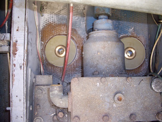

Here is a view of the V-Drive raw water inlets.
I temporarily used the through hulls as guides for the plates. I "buttered" the plates enough to have epoxy ooze out all around. 2 added benefits is that on the outside circumference, I was able to make a fillet and it leveled the plate with the outside of the hull so that the everything is parallel. the seacock and through hulls will sit flush with the hull. Since I am doing this alone, it was easier to put the through hulls from inside and put the nut on the outside...
So. I completed the 2 raw water engine cooling inlets and the 4 V-Drive water inlets and outlets.

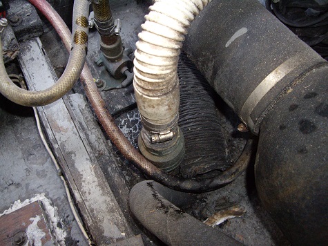

I also tackled 2 in the port lazarette. One for wash down water and the other one I'm not sure what it's for... :(
I removed the through hulls and valve/seacock and prepped the hull to receive the plates. Access was brutal but in the end it was the easiest to do in terms of removing the hardware, cleaning and prepping. It went surprisingly well. :D
While being there, I noticed that the hose for the blower was completely shot. I will replace that this week as well.

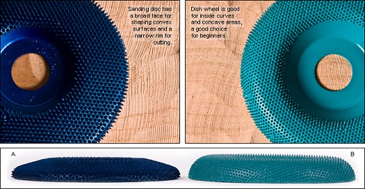

1- the hull thickness is 1/2 in such that a 12:1 ratio would bring be to a 6 inch radius all around the hole :shock: It will take for ever to grind it down. So I was thinking of getting this item from Lee Valley tools:
It should help a lot. Any of you have experience with this grinding wheel?

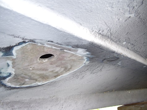

2- I have a feature in the way. I don't know what its called but I am sure it has a name. Here is a picture:
Does anyone have an idea on how to resolve this? No sure how to proceed on this one.

OK Google is my friend! They are called Lifting Strakes. This is what is in the way. Should I grind it down as well or stop to it. Is there wood in there of just glass?...

I used a few different tools when I was patching old holes. on the hull (+-1/2 inch thick) I used a 4 inch grinder with 36 grit sanding disk on a flexible rubber pad. on the thinner fiberglass (cockpit sides) i used a 5 inch DA sander up on the outside edge with 60 grit. I wouldn't worry too much if you cant get the full 12:1. what your trying to do is give yourself more surface area for the epoxy to bond to and enough depth to allow you to build up enough layers of fiberglass to provide sufficient strength . i patched a hole for an old transducer by beveling the both the underside of the hull as well as the interior of the hull. I believe I went about 9 inch diameter to fill a 1-1/2 inch hole. by beveling both sides It gave me a sufficient thickness of new glass that was were keyed together through the hole.
If it were me I would continue beveling up onto the strake but be careful not to go through it.
