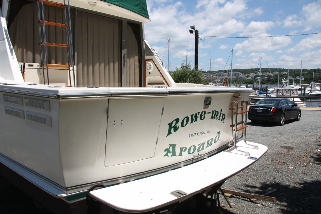

Here are some of my door. It was done by a PO. The cover is off and I will try to get some close-ups for any one brave enough to attempt this project.
1988 Trojan F36, 2004 Palm Beach
Posts: 12725
Re: A small project or what have I gotten into
They did a very nice job looks better then mine . The deisigh looks the same as mine But I did mine on the starboard side .

I noticed the inner liner seems a little different . But its its 10 years newer so thats most likely the reason . I will try and get some good photos of mine . Its 90% done Door and top open close just some slight tweaking and fish work needed . But its 100% usable now

prowlersfish wrote:I noticed the inner liner seems a little different .
I noticed that too. I have never been on one as new as 1988 though. I bet there are a bunch of things that got changed over the years. I'd be curious to see.

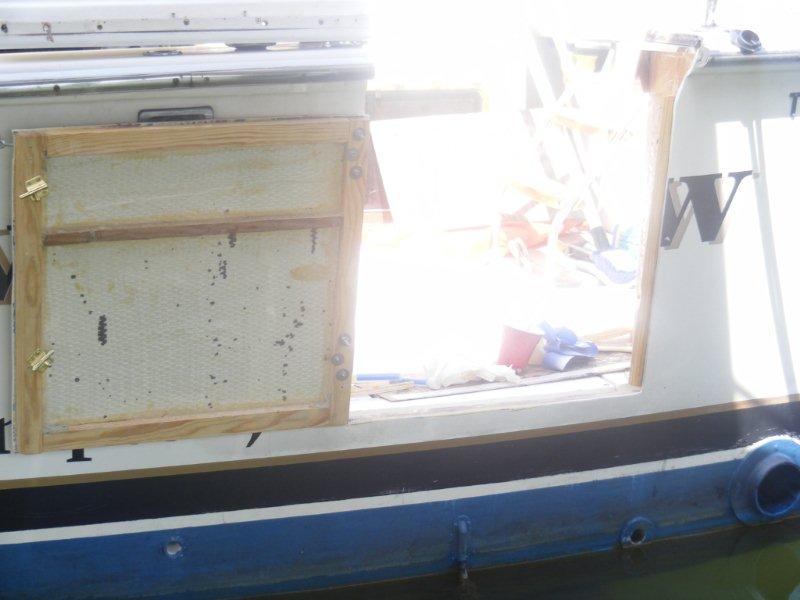

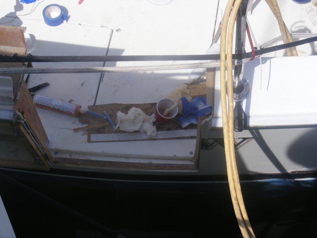

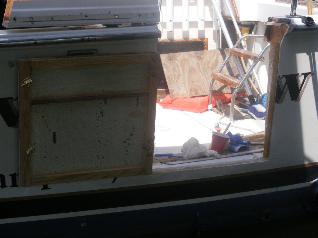

Still got a way to go . But the door is now usable as is the boat .The temps have been hanging around 60 deg and chances of rain . Not the best conditions for epoxy work . these where taken sat. got more done on Sunday .

I wish I took some sunday , I will try and take some more this week .I need a few days of above 60 and no rain and it wll be done .
